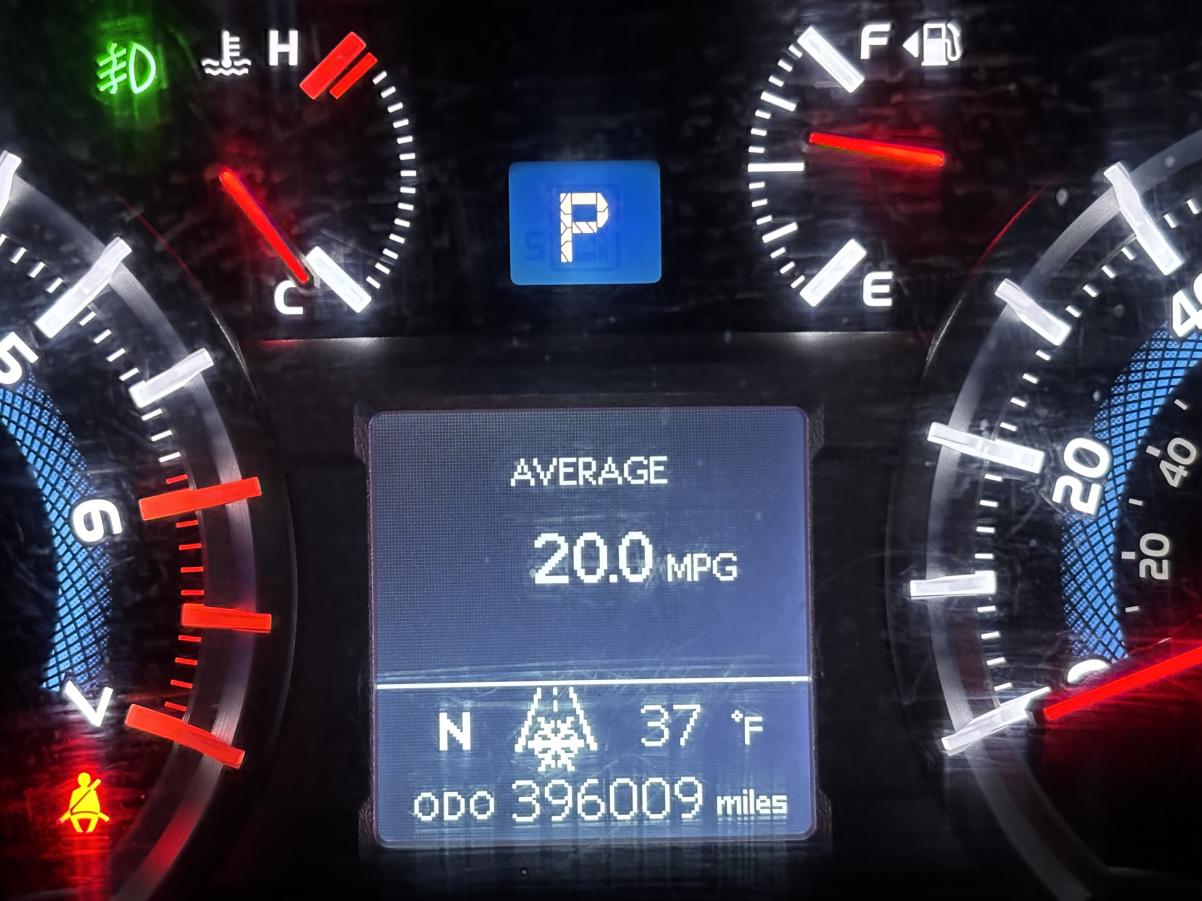

Wife has the 4R up at our Montana home. Last reading/pic had it at 396K miles. It has been a very dependable engine.
