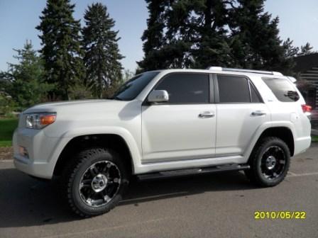

What I have and what I want...let's pretend like money is no object.
I have the ToyTec 3/2 spacers installed currently along with the front differential drop kit and 20" wheels and BFG AT's.
Rides rough (a small bump will almost put your teeth through the roof of your head)
Brakes abrupt
Chrome Roof Rack vs. TE
Giddy UP!
1. Remove spacers completely and go with the Icon Suspension System or keep spacers on and do? to improve ride? If you keep the spacers what will work with them to better the ride?
2. Icon Suspension System, what's the difference in the stages?
3. Would replacing the brakes help at all?
4. Has anyone with a TR5 replaced the roof rack with a TE yet? Does it fit the same or do you need to make modifications?
5. More power please! What can I do to get some more giddy in my giddy up? I understand it's not a race car but everyone could use a little more power...

2. Icon Suspension System, what's the difference in the stages?That's kind of a confusing thing as they package stuff together with there best front and rear shocks and some of it is overkill IMO. They do sell separate components so you can build as you go if you can't afford the package.ICON Vehicle Dynamics
This is a great setup for less.
Icon Front Ext. Travel CO's $925 pair
Icon Rear Extended Travel Piggyback shocks $600 pair(You can get the regular 2.0 inch Icon rears shocks for $200 but the 2.5 inch are a better match for the front 2.5's)
Light Racing Upper Control Arms $379
Icon ($200) or Sway A Way($205) rear springs -The SAW's are a little softer and give a 1/2 inch less lift in the rear.
Add about $150 shipping
So for a little over $2000 plus install you will have a real sweet suspension and really only about $400-500 more then the Toytec Ultimate set up
