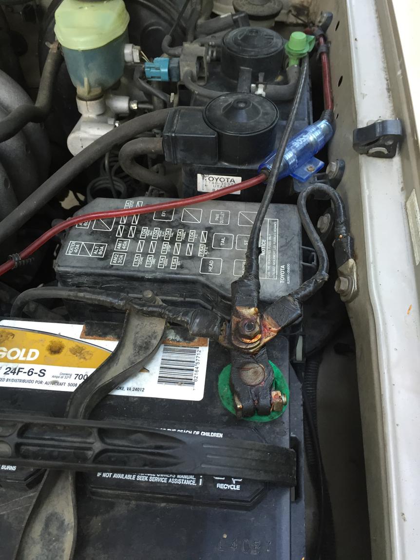

So, my battery terminal connections had seen better days, so I decided to replace them. The positive side wouldn't really tighten up on the post and was easily moved by hand and the ground was corroded and cracked.
Anyways, I got everything replaced fairly easily, but after getting everything reassembled, I realized I forgot to reattach the short little wire that grounds to the drivers side fender. I started the truck fine, and even drove it around for a while and everything seems totally fine. Is that little wire really necessary? I can't see how it really accomplishes anything, but figured I'd ask here.
What do you guys think?
There is a ground going into the engine and then you'll see another wire from the engine to the fire wall area. This is the second body.

Grounds are equally as important as positive wires. The whole body on our trucks is used as a ground and all the switches and lights in the interior use it. The reason you can't tell the difference is that there are multiple pathways for the body ground to reach the negative terminal. Most likely the ground is running through the firewall to the ground on the back of the engine and then through the main engine ground. Fix it. Buy a lead marine terminal if you have to and solder new ends on the wire. Your 4runner will start fine because the main engine ground is good but you will start having issues if you have lights on when you start up

My tacoma The middle wire is a #6 wire that runs to the frame and then directly to the main engine ground so there are two pathways for starting. It cut my starting time in half

It is factory Most of the switches,lights, ecu are all grounded to the metal of the body. The body itself acts like a wire and that wire on the fender ties the body to the negative terminal. As I said before there are other pathways for the ground to run but you are forcing those other pathways to work harder than they were designed for. If that was a positive wire you would fix it in a heartbeat without thinking twice. The ground is equally important and should be fixed just as quick
