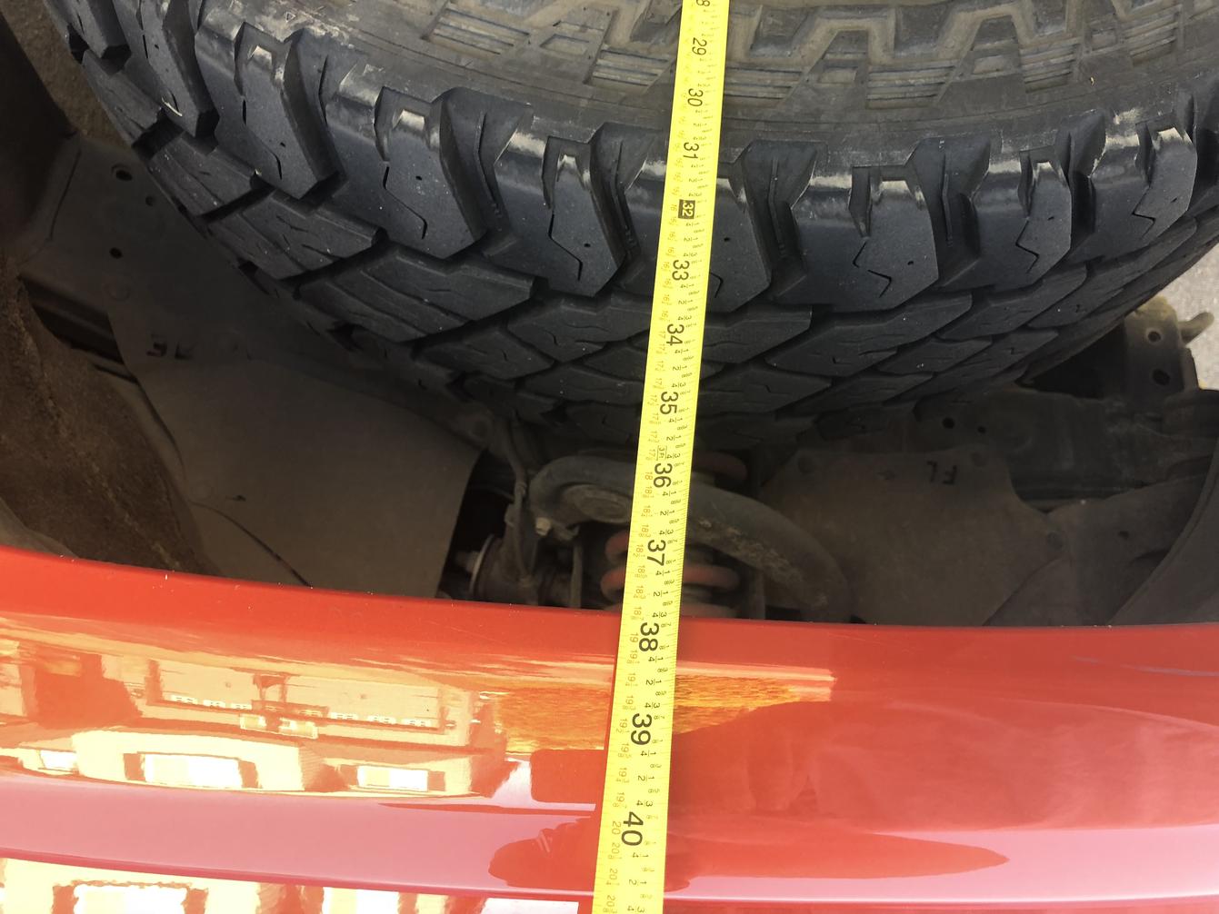

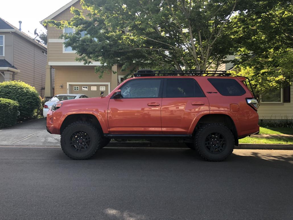

Here is mine with SAW coils. Not sure if you have any better option for coils if you want to minimize rake, I’m really happy with mine both in lift height and ride quality. They have definitely settled a bit, I’ve had them on for about 20k miles. 37 3/4” up front and a hair over 39” in the rear. Sorry I can’t get that picture to flip over haha but you get the idea.
This looks great. ~1" of rake is the ideal look IMO. Every time I see this color, it makes me wish I had got one. So good.
