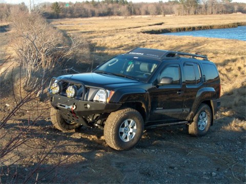

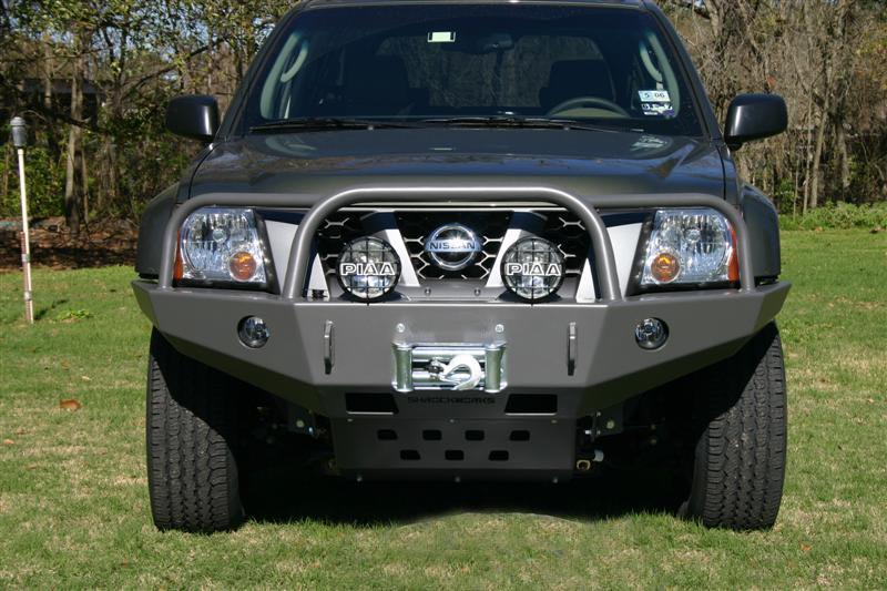

Some pictures of the bar made for other SUV's...looks hot!

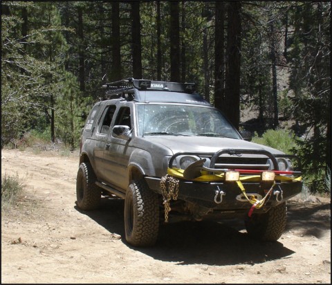

lastly...
If your interested in this bar go to Here
Or if interested in ordering in the first batch go to Here
If you want to check out Shrockworks company site go to HERE
