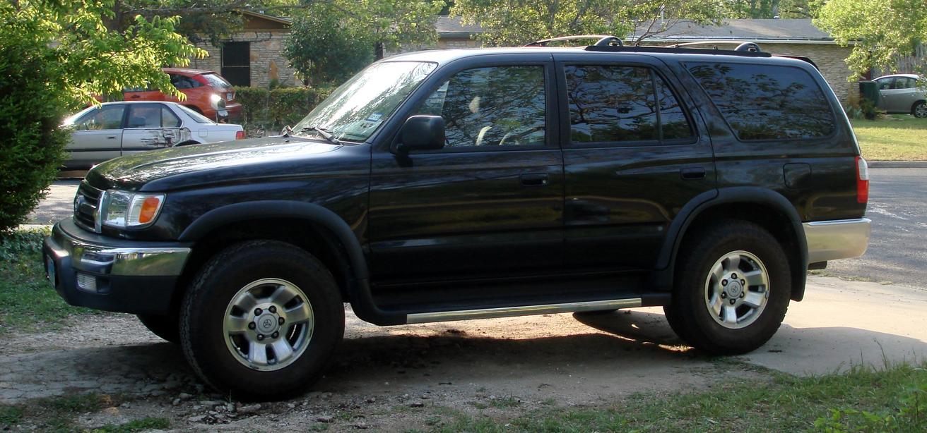

Well after several setbacks and well spent money, I finally got my 4runner up and running. Bought her awhile back with a blown engine. It took me several months to find an engine I could afford, and someone stealing my cat while waiting to install engine.
(hope Karma gets them back for that one)!
I was a little disapointed when I failed state inspection with a P0172 engine code but was able to track down the problem with all the information posted on this site (Thank You Everyone). Turned out to be a dirty MAF sensor.

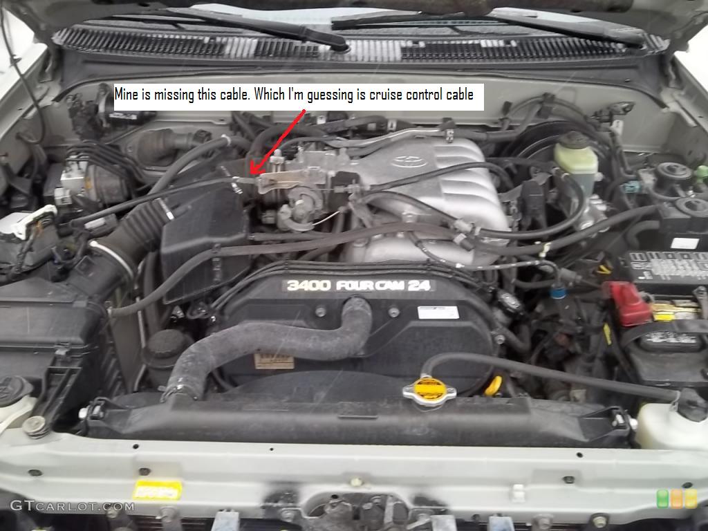

As for my cruise control issue, it may be the fact that my cable is missing. I can't even find where it is suppose to get hooked up to on air cleaner side. Here is a pick I found of a motor with what I'm guessing is cruise control cable.

Ok so found my cruise control cable tucked in the fender. Works perfectly now, but I'm still getting the P0172 check engine code and it's driving me crazy!
