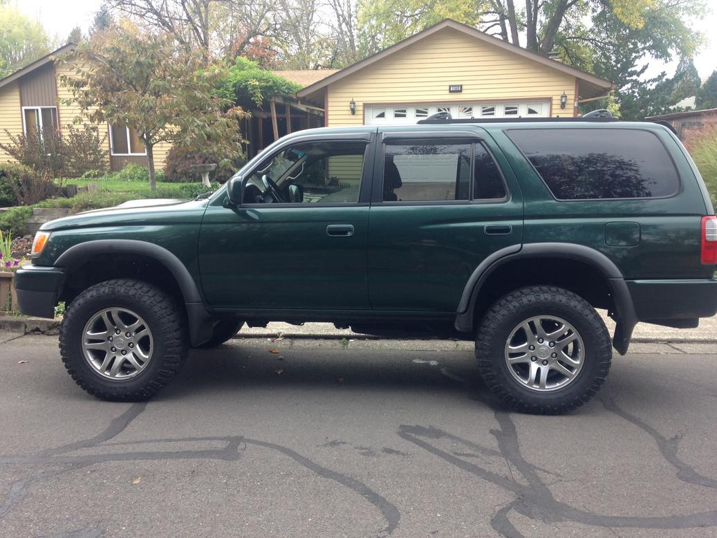

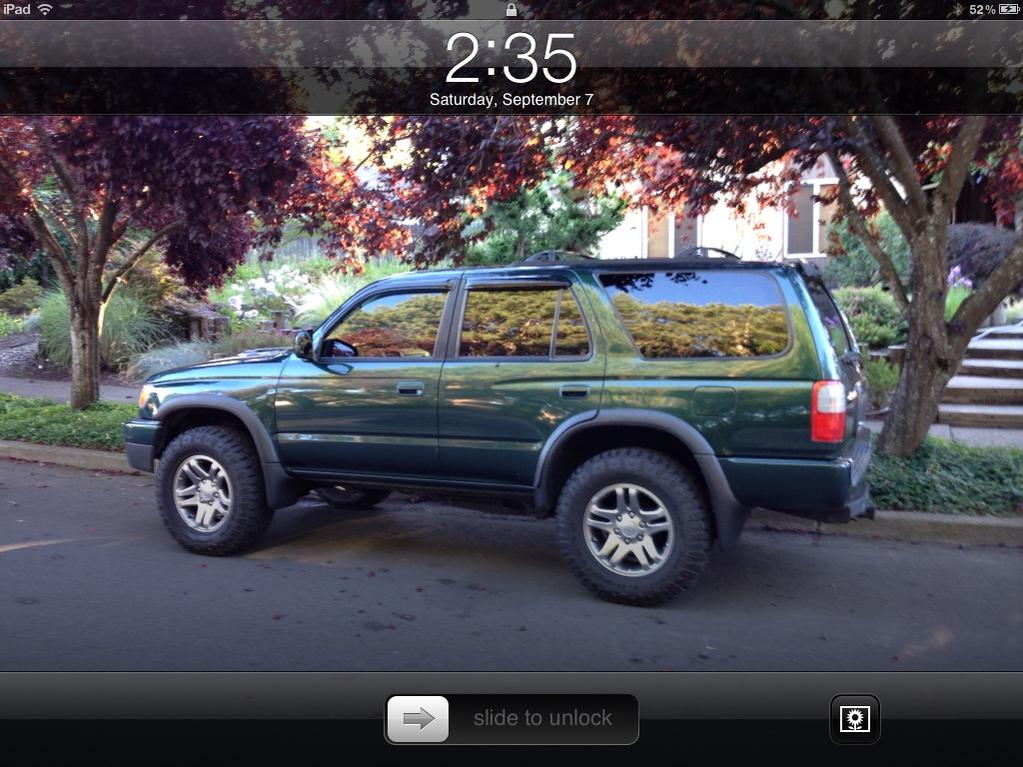

Well guys, she's done!!
Took about id say another two hours to get the rear in, I got lucky and just twisted the rear driver shock till it broke off....lol
Thanks [MENTION=96608]MandAtaco[/MENTION] for the rears, everything worked out good!
Mike thanks for the offer to come down and give a hand, I really do appreciate it!!
Before:
And after:
Sitting at 23 in the front you were right Alex!
And 23-1/2 in the rear!
