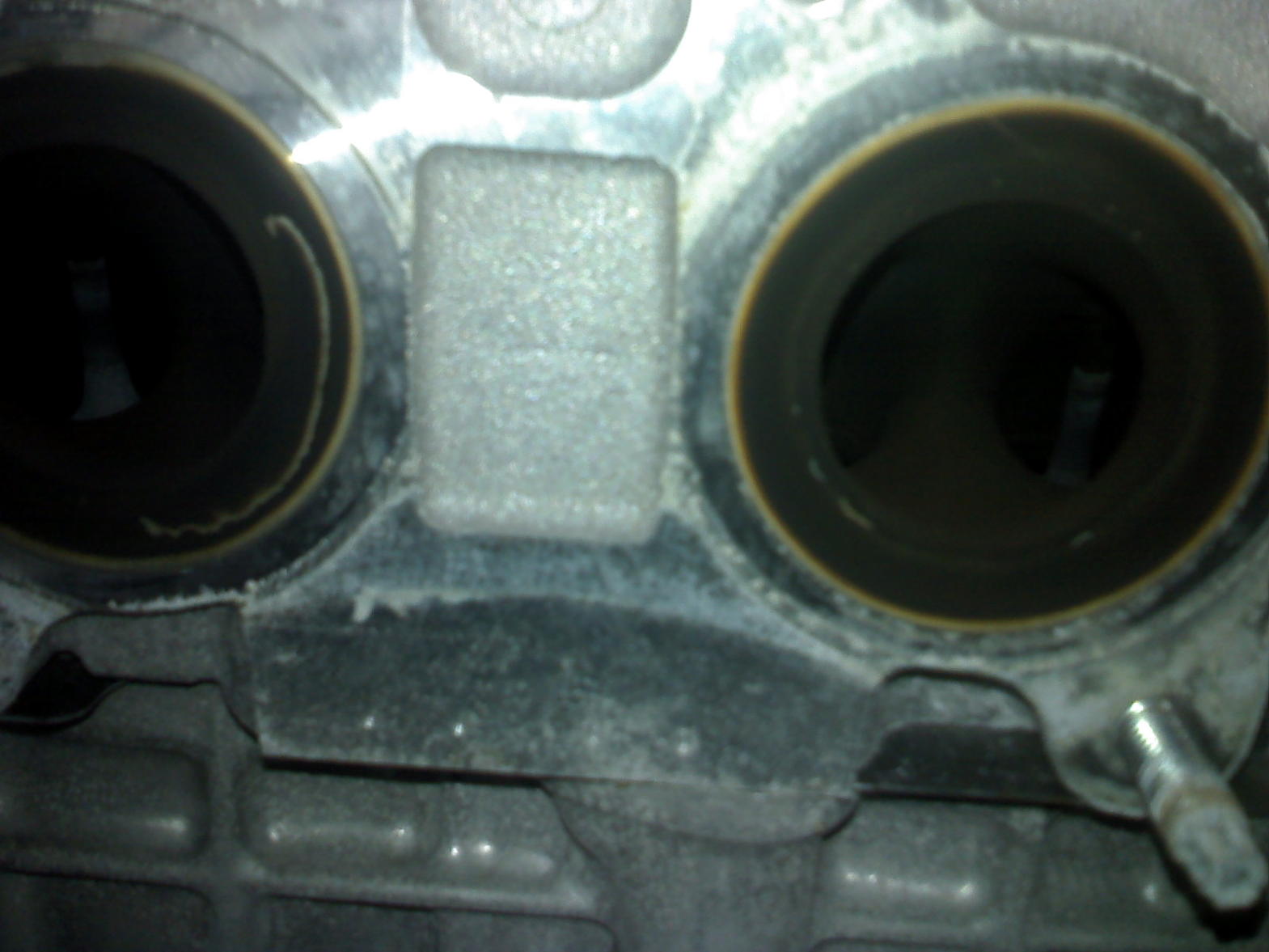

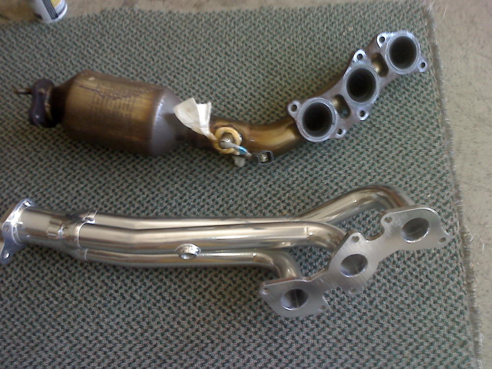

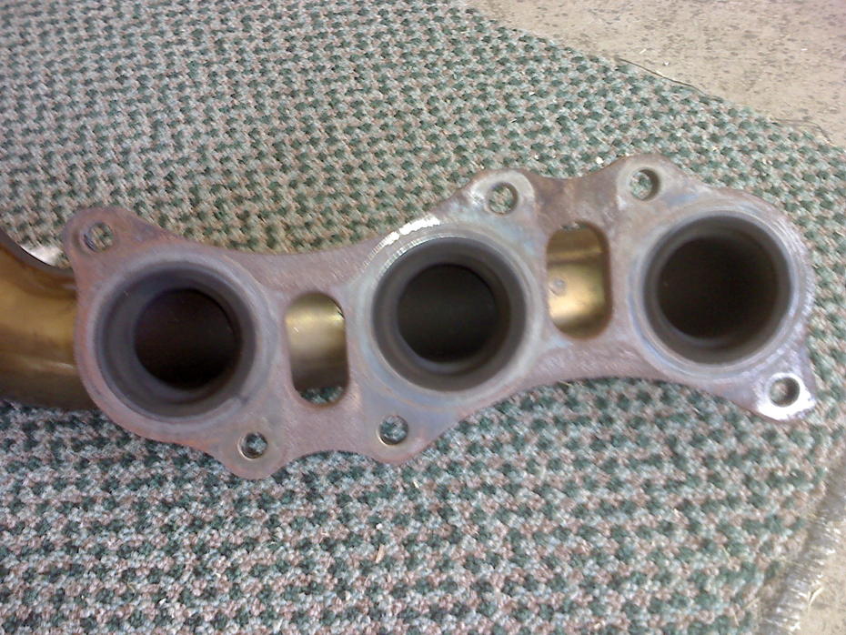

Ive finally installed my doug thorley headers on thursday in about 6 hours. i took my time to not screw anything up. ive got some picks attach. when i took the stock headers off i tied a paper towel to the sensor and PB blasted the towel wet then began to work on the other header.(this way it had alot of time to soak the sensor). i did the when i removed the second header and started to remove the sensor on the first one. i had remove all the studs as well. i had placed some rtv glue around the header and gasket just in case of any leaks and installed the headers. i had threw the headers on and had a friend hold them until i re-studed them with blue loctite while the headers where on the block (for clearance issues, tip from mike07*). torq the nuts to 20 and bottom flanges (connector to y pipe) 45. correct specs where 16/46 (i found it from a pdf at XR underground with the corresponding link http://ncttora.com/fsm/05+/data/ileaf/06toyrm/06toypdf/06rmsrc/rm2006ta/00701410.pdf)

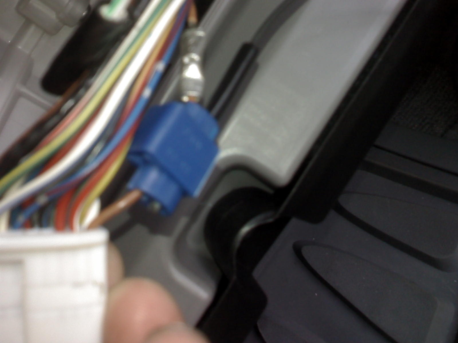

*after installing the headers i installed the o2 sim....on the urd instructions one of the wires were to connect to a pin# with a certain color(white with green stripes?, although i attach to the pin# the color was different (brown). so far no problems:thumb3:
