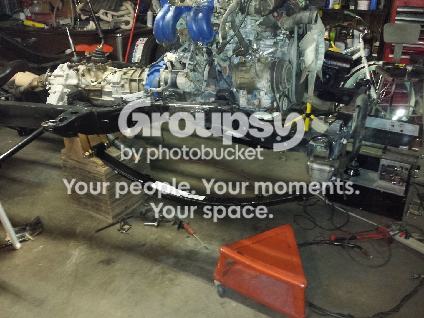

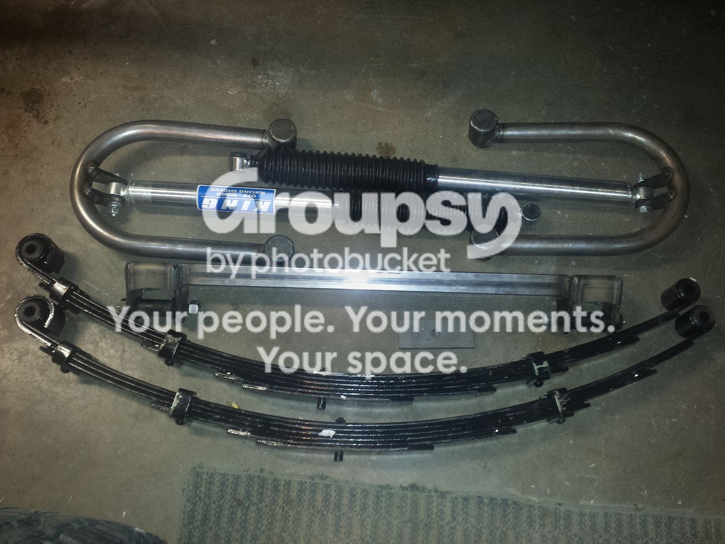

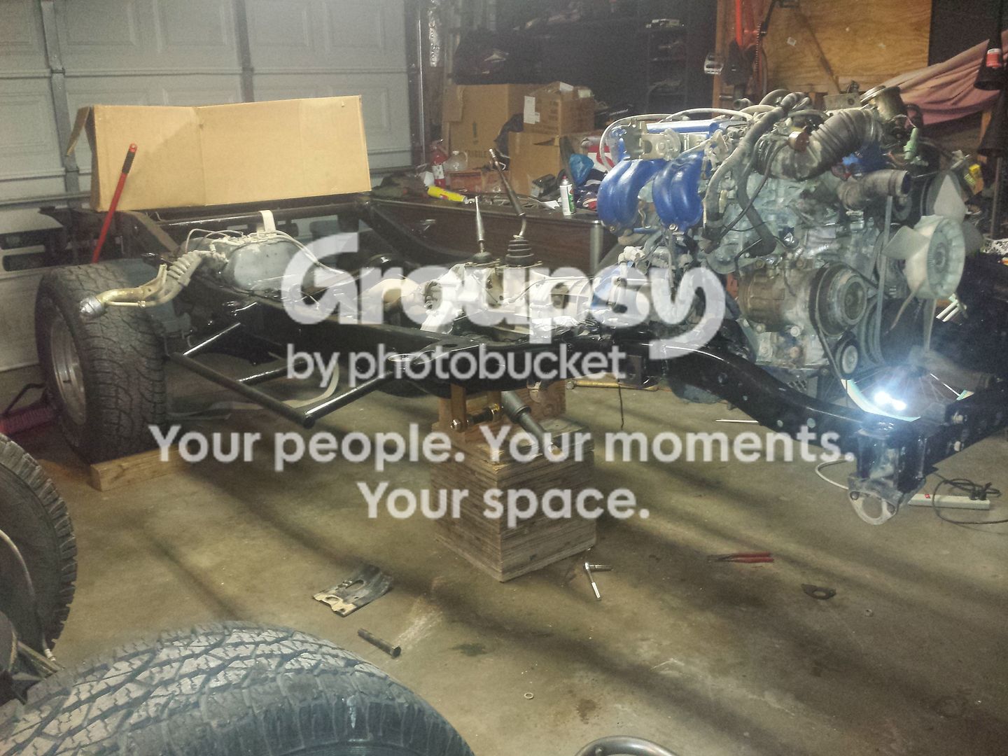

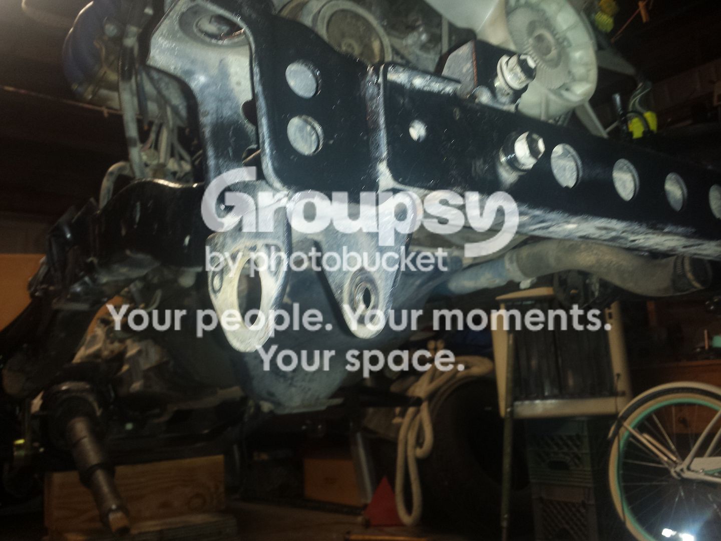

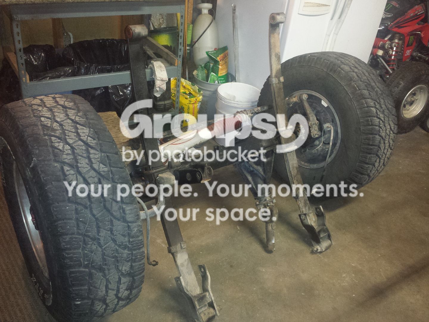

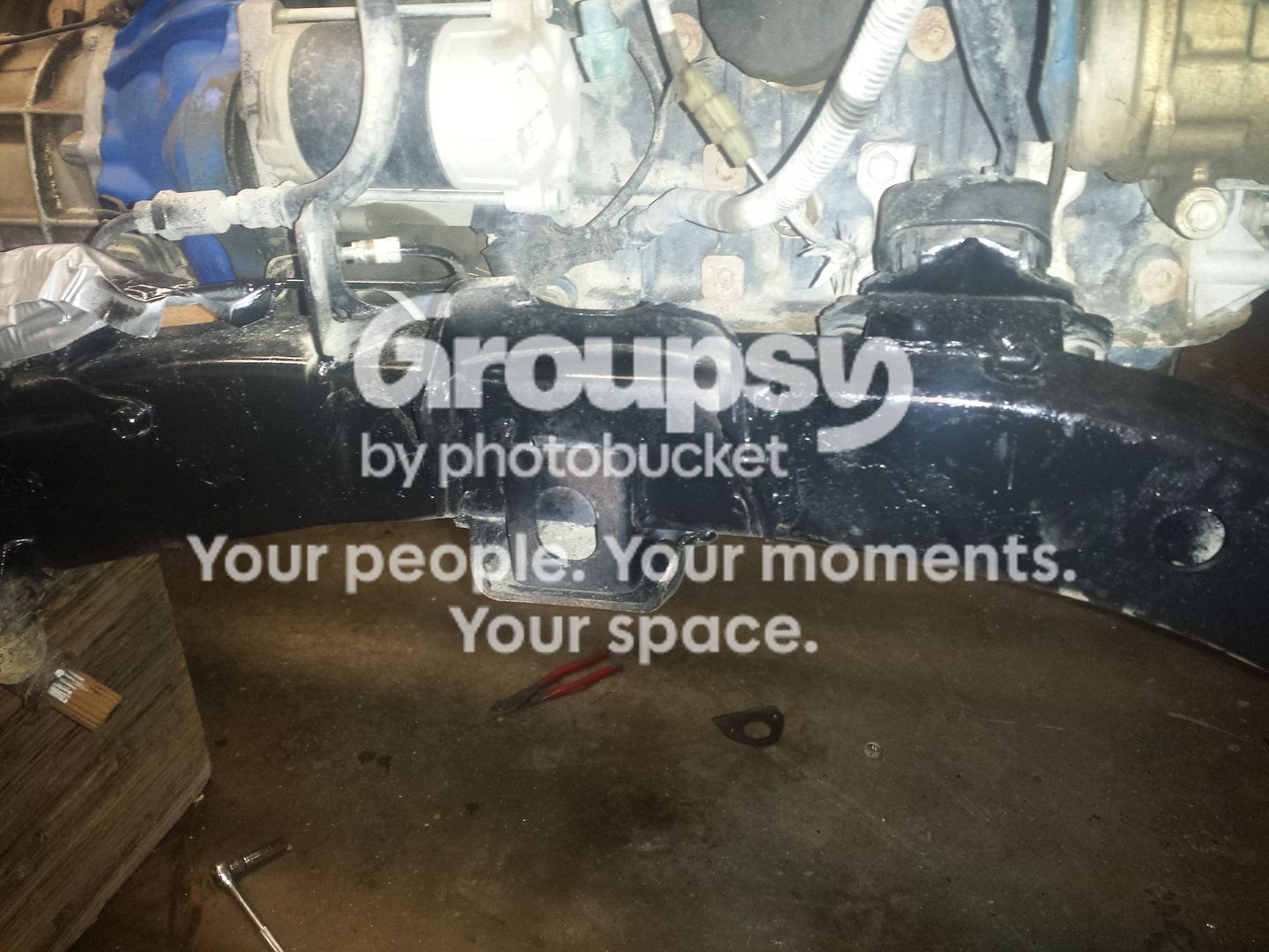

Well! After 3 months of waiting for All Pro to get a new shipment of front 4 inch lift leafs, they're finally here! :reddance: From the time i ordered them, i ordered the entire rear 5 inch kit, installed it, broke the rears in, AND rolled my truck! Woo! Figured since i have the body off, it'll be a lot easier welding the front hanger and shock hoops on.
Heres some pics! Gonna be updating this thread regularly until im done.
20150807_001531_zpstw0skvpv.jpg~original
20150807_001547_zpskmfvxk0j.jpg~original
20150807_001633_zpshpddbkmf.jpg~original
20150807_001619_zpsjxyeqtvr.jpg~original
Already cut off the stock shock mounts. Just need to finish cutting them more and grinding everything down flush with the frame.
20150807_001606_zpsplo4uktc.jpg~original
I also still need to cut off the old leaf mounts and weld the hanger on.
20150807_001558_zpsuie3lkum.jpg~original
More to come. Gonna go buy some cutting wheels tomorrow and cut the torque rod mounts off the frame, and axle, finish getting rid of the shock mounts, and cut the old leaf mounts off. Stay tuned! :whoo: :hello:

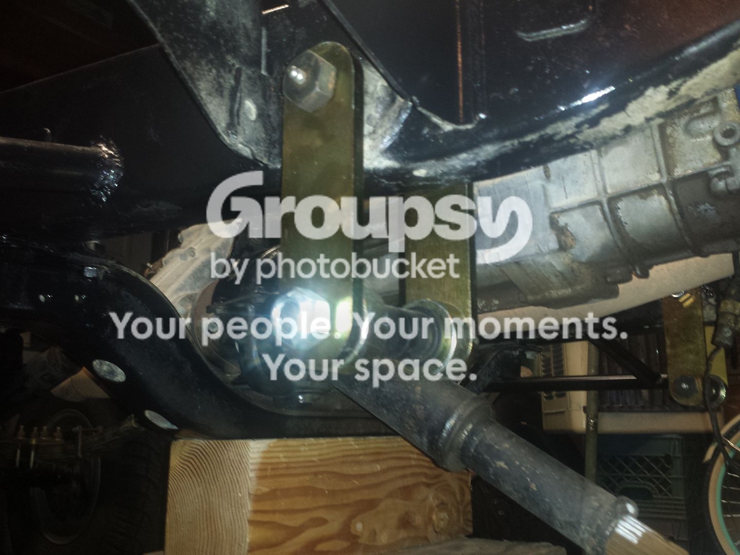

Well fellas. I got a lot more done in these past 2 days. Got a hold of a plasma cutter and cut the rest of my shock mounts off, cut the leaf mounts off, and cut all the mounts that weren't needed anymore, off of the axle. I now have the axle all mounted up to the leafs and the leafs mounted to my frame. Heres some pics! Its been a fun, messy couple days.

Like i said, leafs are mounted, and my axle is mounted and all painted. Theres a lot more done, but i cant show 2 days of progress in one post! Ill show more later tonight, or tomorrow! Also, ran into a steering problem since im not doing the Hy-steer. More to come! Heres a teaser ;)
