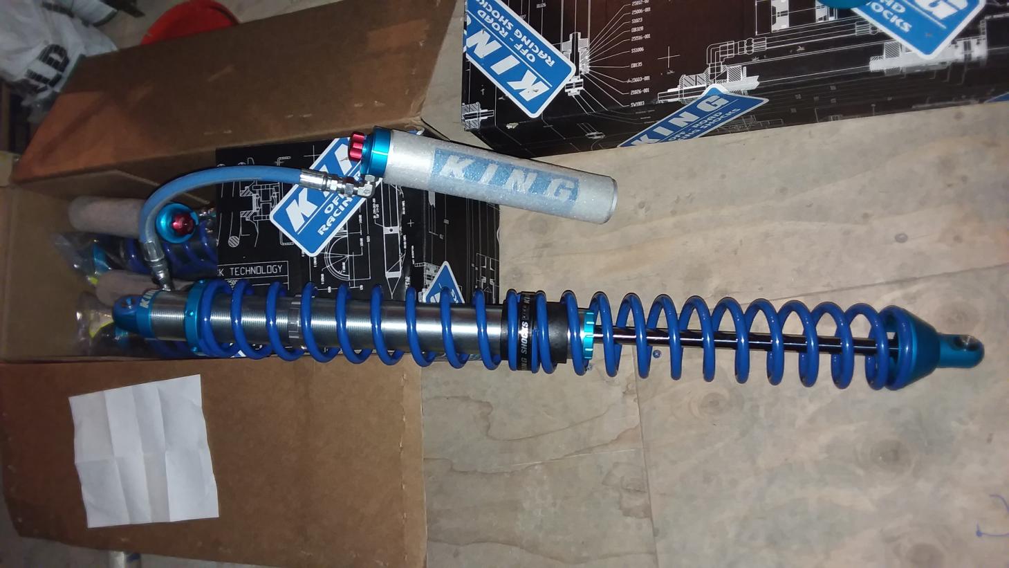

Took the king leap also, 3 and half months to get them with everything going on... still waiting on the bump stops they forgot to ship with the coilovers.

What is blue blazes are those!? Good Lord lol

Wow I didn't know th super flex could set so low, I thought they always had crazy lifts. I might have to look at them down the road.

When you say remote reservoir, are you talking about the tank on the hose? I ordered the ones with tanks piggybacking on them with adjuster jobs.
[MENTION=144196]Jross[/MENTION] - yes, the piggy back with adjusters is the resi for them. They make a big difference. I do not have an armored bumper on the back of my 4Runner so it is lighter than some rigs. I ordered through Filthy Motorsports and had them valved for my rig before they shipped them. The ride is great and worth the coin.
