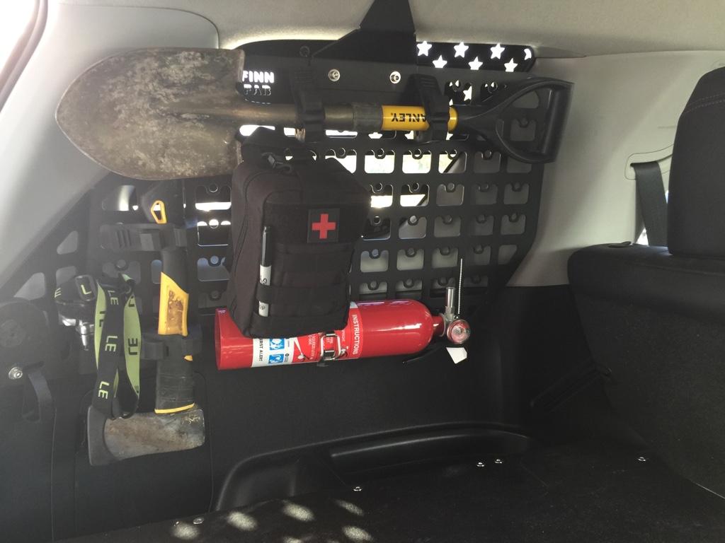

This how i have mine mounted. I feel like the 3 points that secure the molle panel and the fact that my shelf now ties the panel to the opposing panel should provide a very stout mounting in the event of an accident or rollover.

What is “safe” is subjective. However I considered the placement as best I could for access and just if a crash occurred… where it might fly. Ended up mounting it driver’s side as low as possible, low enough the first point of contact is the back of the passenger seat…
And ya I know passenger side would probably be better as I’m solo most days.

Perhaps mounting it vertically and using two mounts to hold it in place? The horizontal mount looks like it's armed to fly.

Seems like the shovel would be just as dangerous if not more so than the fire extinguisher let alone the hatchet
I’m not the OP… everything you see is secured and clamped with rivnuts and 5/16 bolts The fire extinguisher is in a metal mount with rivnuts/bolts too.

While not a subject matter expert, I took linear momentum into consideration… shovel/axe secured with quick-fist clamps, rivnuts and 5/16 bolts. Note the axe is upside down… mass is lowered. Good enough for me.

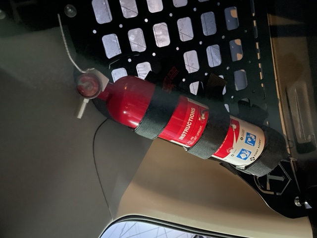

If I decide to go with a molle panel mount, what would be the best combination of a secure fit and the ability to quickly remove in an emergency?
I tried the rubber strap type but didn’t like it. Now use Velcro type that the jeep guys use on the roll bars. Super secure. Super quick to access.
Guess it depends on your Molle panel. I have the FinnFab style with the rivnut holes… So I used the quick release metal mount that came with the fire extinguisher and secured the mount to the Molle panels via 5/16 bolts
