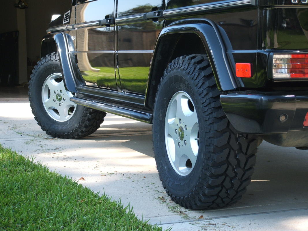

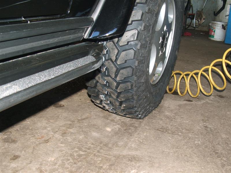

More...you can see the tiny holes to pin the studs (for snow travel)

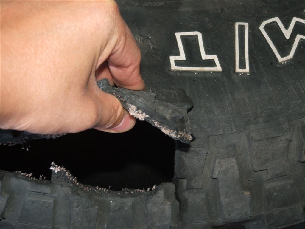

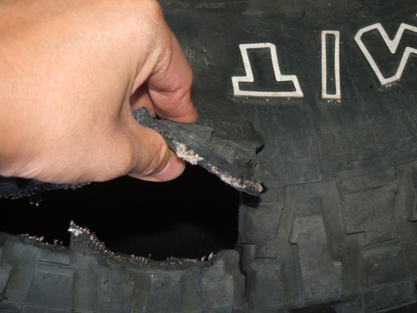

By chance, there was a damaged Firestone Destination M/T in the garage. Apparently, it came from a large diesel truck that slide into a curb at high speed.
Here is a pic of the Firestone's thick sidewall (3-ply):

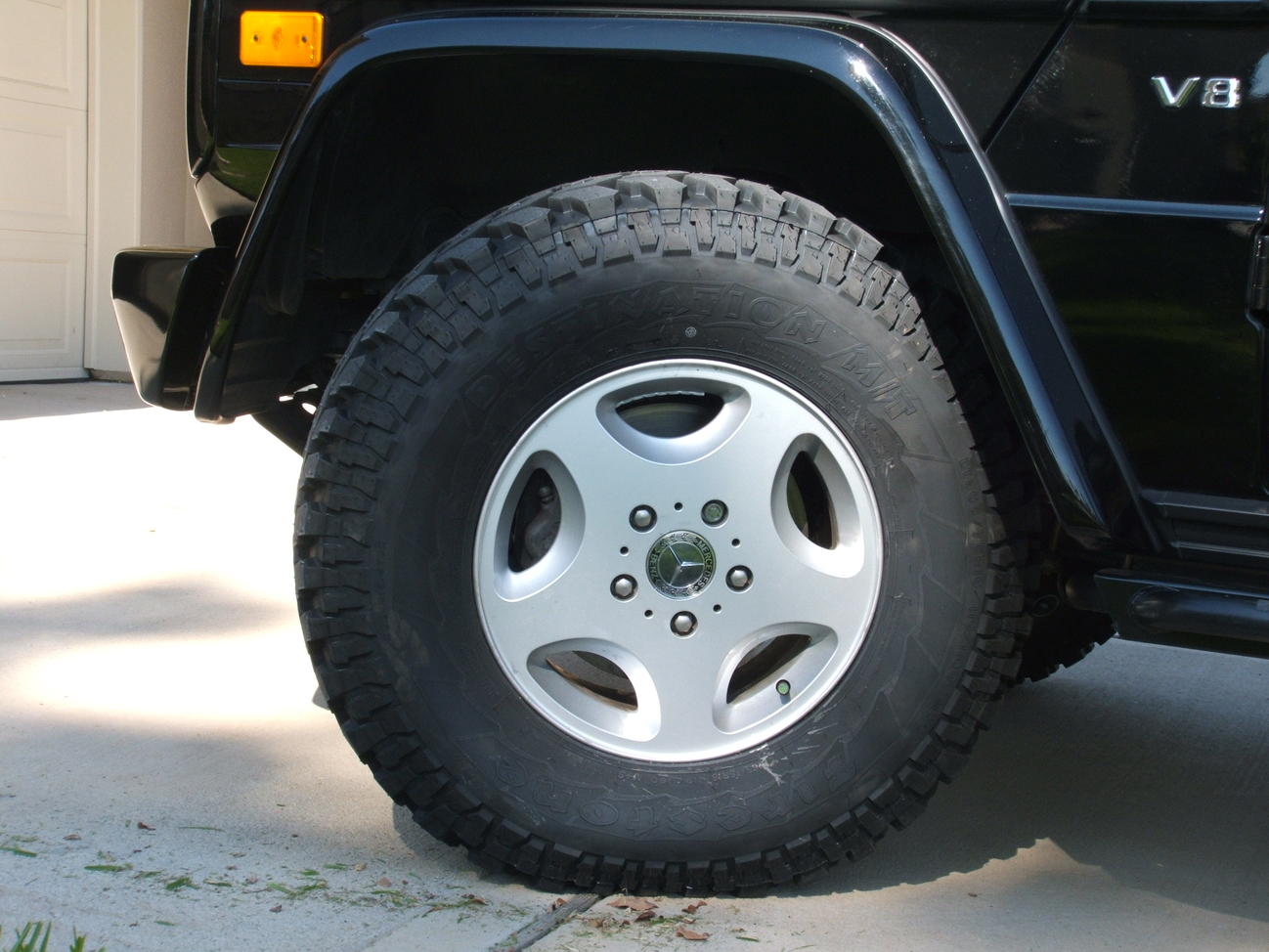

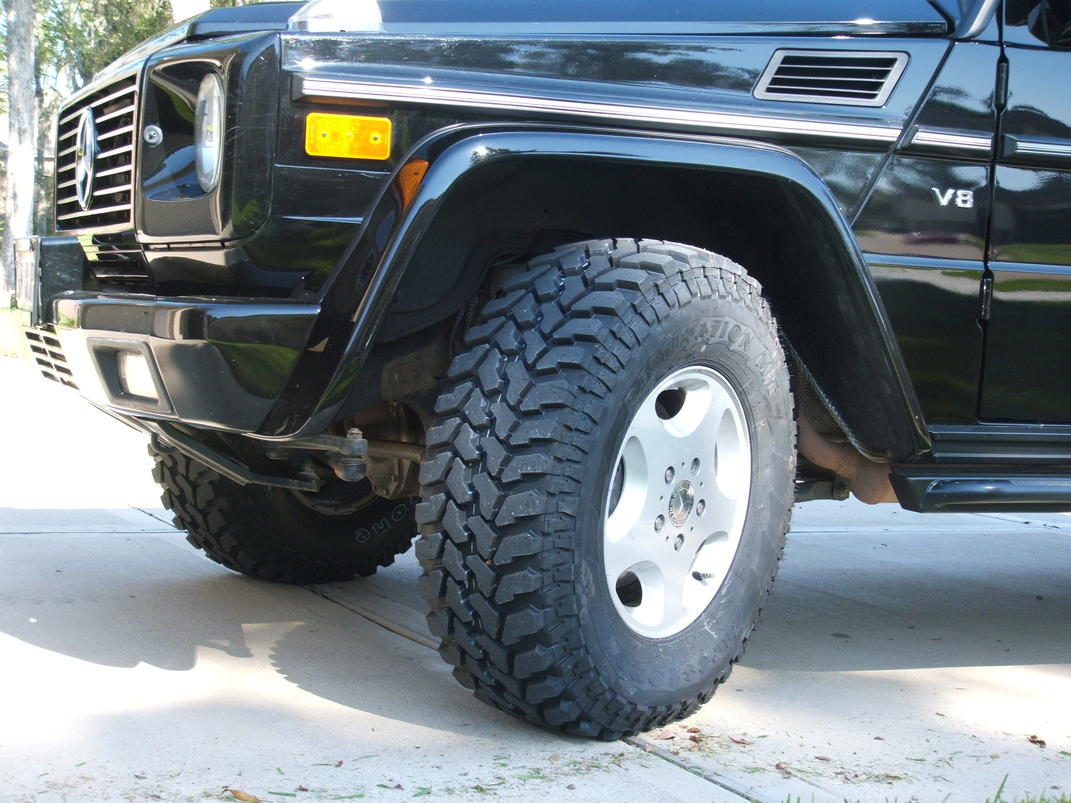

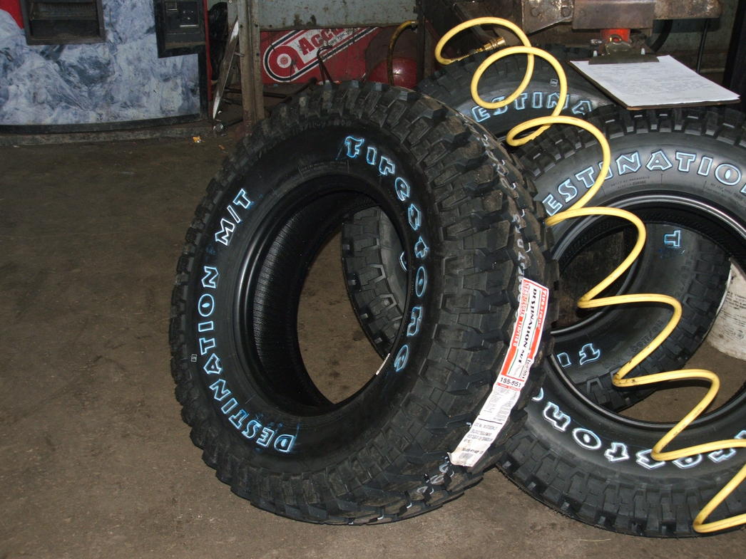

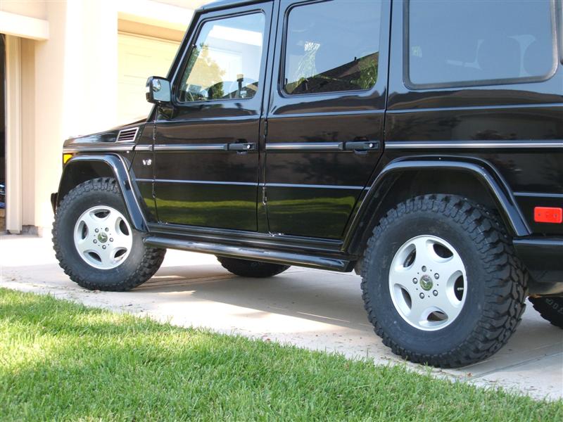

Ok...the review:

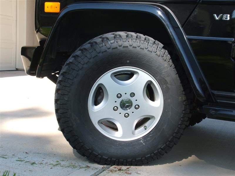

Comparison is to my old tire: BFG AT KO, 265/70/16 (31"), Load Range D
My new tire (as pictured above): Firestone Destination M/T, 265/75/16 (32"), Load Range D
I have been researching M/T tires for a little over a month. Here was my review of all of them (based on other people's review over the net):
http://www.toyota-4runner.org/showthread.php?s=&threadid=22027
Ride comfort: I would say that the new tires ride better than BFG AT KO...it is more comfy. (I don't think that i am bias here nor suffering from trying to justify my decision.) I think that the lugs are softer than BFG and there is more cushion between road and rim. The tread depth is 19/32" while BFG is 16/32". The new tires feel softer overall...therefore, it absorbs small bumps much better. Sidewall maybe more flexible.
Handling: This is where BFG is better. The new tires feel "tall" and soft. You can wiggle the steering wheel and see the lag in response. BFG seemed to provide more ride control, but Firestone provides better ride comfort. Leaning is probably a bit more with the Firestones.
Weight of tire: According to Tirerack, BFG AT KO weighs 51 lbs. According to Firestone website, my new tire weighs 53 lbs. Tirerack quotes that my new tire weighs only 48 lbs. I trust Firestone website...and i am not even sure if my old BFG weighed 51 lbs because Tirerack is apparently wrong with my new tires. So, who knows?! Both tires probably weigh within a few pounds of each other.
NOISE level: (this is my most important criteria) The new MTs do make significantly more noise than my old BFG. On normal pavement, it is noticeable (slight hum), but not bothersome (remember, i am really anal about this). I don't think that an outsider will notice much difference. However, over coarse pavement, the new MTs do make much more noise (some droning with humming). It's tolerable and can easily be drowned out by music.
Acceleration/Braking: I did not test emergency braking yet. Braking seem normal for daily driving. Acceleration does suffer a bit, esp. when getting up to highway speed. You just have to press the gas pedal a bit deeper to get the same push. This is the least of my worries...and expected.
Appearance: It just looks sooooo cool. The overall look has just the right amount of aggressiveness without being too "redneckish" or gaudy/overdone. The tread design looks mean and ready for off-roading. I like it a lot. I would rank them just behind the Goodyear MT/R in looks, but better than BFG MT (too plain jane) and Cooper (too redneckish for me).
Overall, i am happy with the new tires. Most of the things above are expected when you go to an aggressive high-void MT tire. I am still a bit on the fence about the road noise over coarse pavement. In the end, i am keeping these tires due to the expected great off-roading capability of these tires, great looks (just right for my G), and durability.
Will keep you guys inform down the road on how these tires perform off-road and durability.
