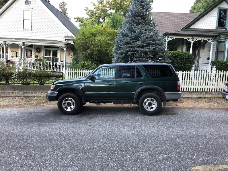

I was given the opportunity to buy a 1999 4runner from one of my dads employees for $2100. I told him if it passed smog I would gladly buy it. I drove it down to the smog station and it passed with flying colors. Since I have gotten it I have changed the oil replaced the brakes and painted it. That was my first paint job I have attempted on a vehicle and I am glad that is over with. The original color was the pearl green I believe it was called and it was just way to expensive to buy the paint. So I researched and nearly settled with raptor lining it but then decided against it cause it was to permanent. So. I went with an industrial enamel single stage paint. Prepped it painted it and it turned out ok. I had some issue with my gun at first but eventually got it spraying right and am satisfied with the paint job for what I am going to do with the truck. It’s pretty much my hunting and 4 wheeling rig. So now it’s time to put a lift on it. I’ve done as much reading as I believe I can do to try to figure out exactly what lift I’m going to put on it and I’ve decided to go with the tundra spring conversion lift. Or based off of the guidance I get on here any other options. I picked up a set of brand new never used Toyota forerunner rims off a brand new Toyota forerunner for $100 that are 17” and they are at the powder coaters now getting sprayed flat black. I want to lift it about 3”. So what am asking is everything I will need to make that happen. I can see myself probably wanting to take the truck up the rubicon one of these dats since I live right there. I don’t think I want to go through everything there but hunting and 4wheelin is what I have this for. Any input you guys have for really anything would be great. I would also like to do a little stuff to the engine for a bit more power like an intake. I am excited to have this and am kinda addicted to tinkering with it which has gotten me out of the house and helped the marriage.

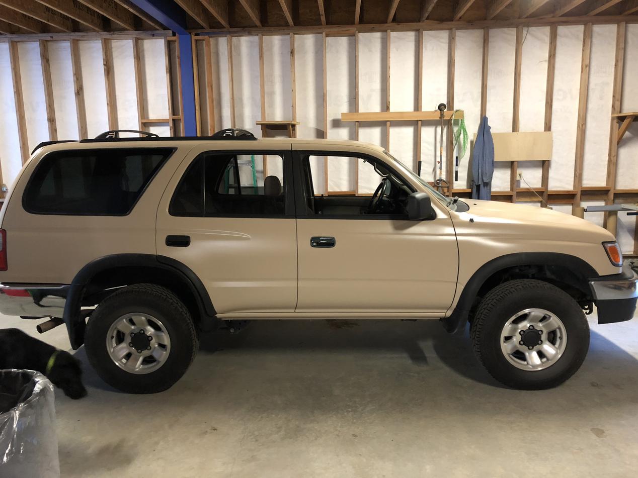

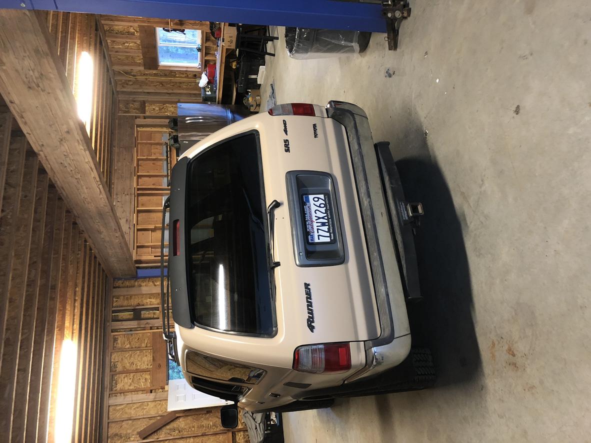

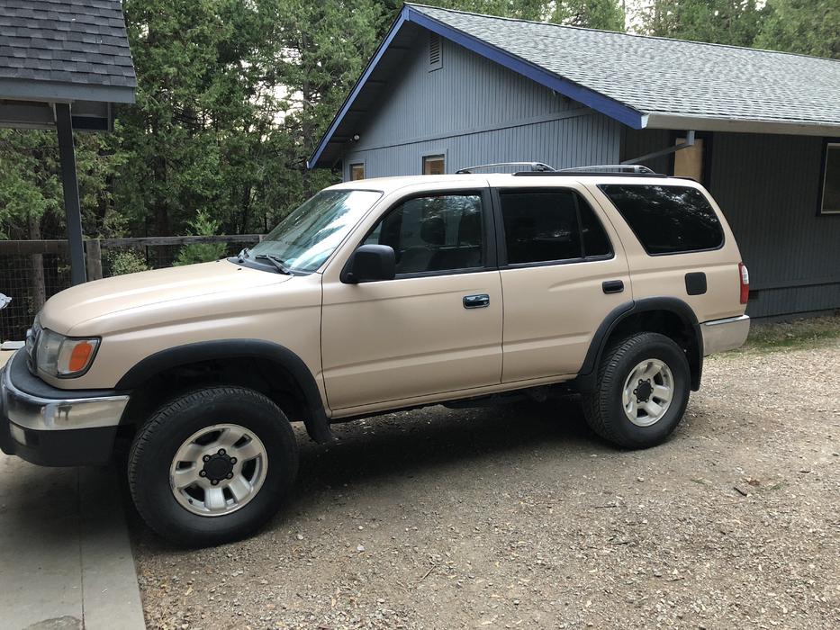

I didn’t like the gas cap cover the black so I painted that the same color but the door handles are going to be black. I didn’t realize how hard it is to pick out a color when trying to match it based off something else. So what I did was used the Rust-Oleum ultra flat khaki color that way when I get around to it I can do the door jams and other touch up areas with a rattle can. Like I said hunting and 4wheeling rig and on a budget. The paint apparently takes a while to fully cure so since I am away on work I have my wife pull it out of the shop to air dry for the day then it goes back in at night. I have a deer hunt planned when I get home and I am going to Ben it hung to take it but I think it will need more time. So when I get some decent tires, wheels , bumpers and roof rack it will look pretty sweet. I almost painted all the plastic trim a flat black but decided against it. Never have good luck with paint on plastic. Oh and the paint I used is between a flat a satin eggshell texture. I am in the military and have always liked the paint texture of CARC paint and that’s what I was going for. This is a little smoother than that though. Paint job didn’t go perfect. I made a booth out of tarps and plastic got a few bugs and blemished a couple spots but kept my OCD in check and kept telling myself it’s a hunting rig and kept going. The only thing now I think I need to do is replace something in the front of the engine. I believe my tensioner pullunbearing is going out or it’s the AC compressor and I’m praying it’s nit that.

Oh and I broke my Toyota emblem taking it off so I have another one coming. I was going to do the bumpers flat black powder coat but their going away eventually.

Sorry if what I said was confusing. So what I did while I was at the paint store was I grabbed a can of the rust Oleum paint that is the camo khaki color and matched it with the industrial enamel paint that I used. That way I could use that for the door jams later. The paint I used was mixed with a a hardener 4:1. It also can be applied direct to metal. So for the prep I sanded sanded and sanded. Where there were dings I sanded to metal filled it in with body filler sanded smooth then used a sealer filler primer. I wiped the truck down several times with acetone finalized it with a tack cloth then went to town spraying it. The paint store told me it’s an extremely durable paint and would hold up well to brush. Will see. Once I got my gun dialed in it sprayed on really nice. I used a HVLP gun at 40 PSI. When I get home I will post the exact paint I used and the paint code if you want it.

Paint turned out surprisingly well, good job.

Nice work on the paint job. If you've never had a 4runner before I'd hold off on the lift for now, especially with a 99 they already sit the tallest. You'll be surprised with the terrain you can tackle. Personally I think the 99 is the second most capable stock year behind an 85 or 86. If you do lift it get a nice coil over setup or something, really no need for spacers. You'll leave jeeps in the ditch as is.
