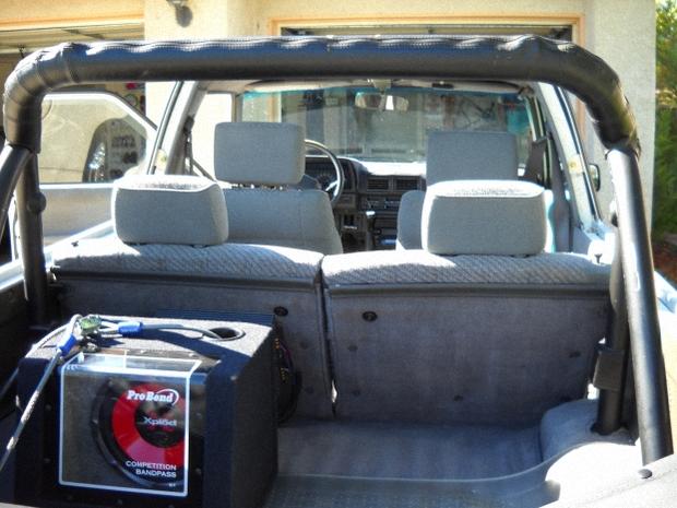

I threaded a flexible heavy duty cable thru holes of my high-lift jack on the floor, around the rollbar and into & out of my 12" (100w) rear sub-woofer (using the duct ports!) - then closed with a Masterlock to keep them from "growing legs". Since my top is off or the Softop is buttoned; it's either in my view OR alarmed anyway! I want to keep a "stock" look; so i used existing front speaker cavities for mid & high. (Amp is mounted to rear of d-side back.)
