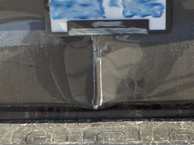

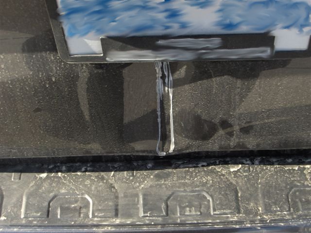

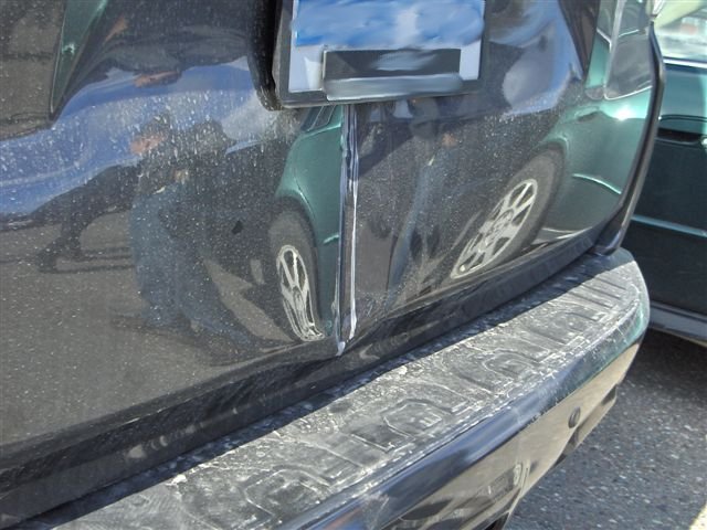

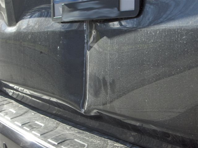

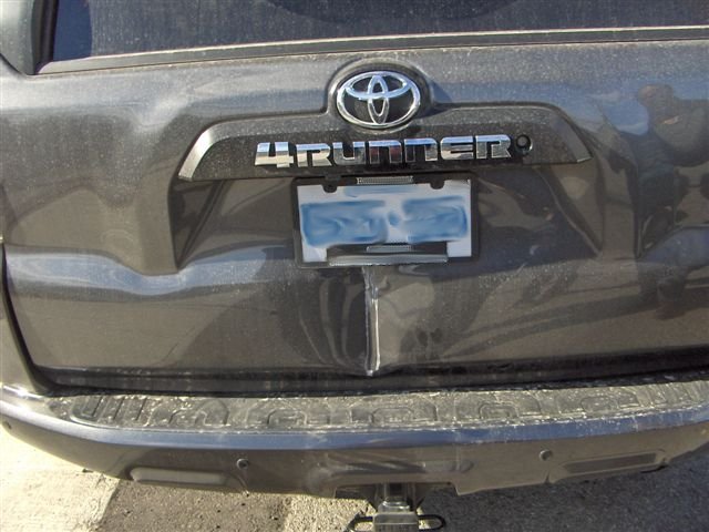

This past weekend I was planning a little ATV tour with my wife – so I was loading the trailer (which was attached to the 4 Runner) with the ATV – when the hitch came off the ball and rode up the back of the truck – I always make sure the hitch and ball are secured – which they where – but I guess the weight of the ATV popped it loose - what a mess – it dented the area below where the licence plate is located and made a huge scrape about 10-12” long right down to the steel.
My questions to you guys is – what will be done with this – do you think they can bend the metal back and paint it or do you think they will replace the whole back door section?

Did the metal crease? If it did you will want to replace it since its a new truck. No crease it can be pulled out and painted.

Thanks guys - I took the truck in today to be looked at - both guys said the same thing - it was creased and they would recommend getting a new skin...so I am waiting on a quote for that.

Basically it means cutting the outer skin off of the door and putting a new one on. The spot welds are cut out and then the new ones are rewelded. Sounds a lot worse than it is. We've done it a hundred times on doors. We don't usually recommend pulling and filling large dents on lift gates because they tend to get slammed and that can sometimes knock body filler loose over time. That's just our policy though, all shops are different.

I actually would probably find a good body shop to try to fix it if it was coming out of my pocket or else claim it on insurance to replace it.I had the lift gate apart to take off just the garnish around the Toyota badge to paint. They cram alot of stuff with the glass and tracks,including lights,locks,wiper,motors,speakers,switches camera ect., inside that liftgate.It would very labor intensive and therefore very ,very expensive to replace the door sheet metal and repaint.

Well I just got my first quote - they told me the rear gate cannot be skinned and they have to purchase a complete door shell - which is about $1100 CDN - with labour, paint and taxes - $2200 - that is amazing how much these parts cost.

Here are some pics the insurance guy took.
Nice first scratch....you can really see the crease in the 4th shot.
