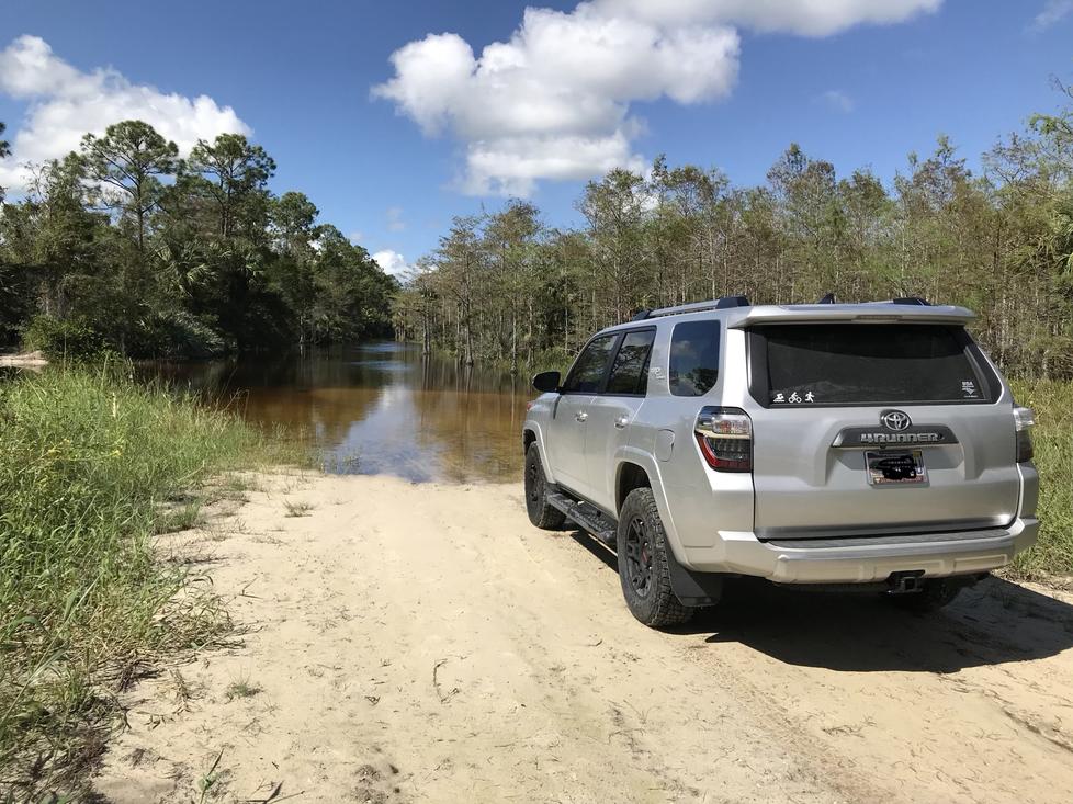

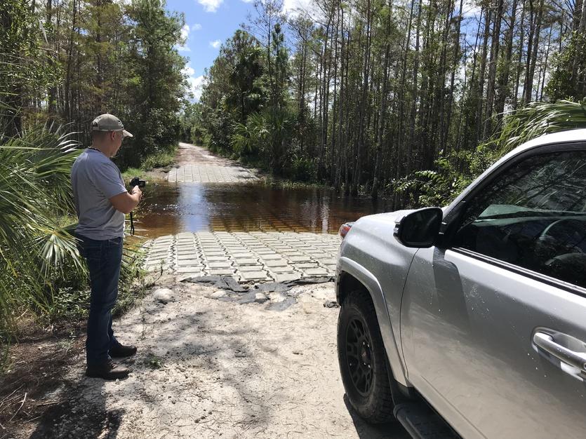

First time out today and had a blast. I'm hooked. Sandy, muddy and a few water crossings. So glad I bought the truck.
Anyhow, also have a few questions. From reading and searching the thread I am unsure of a few things. First, do I need to relocate the breather for this type of water. Next, how well do you clean the under carriage after getting muddy and sandy.
