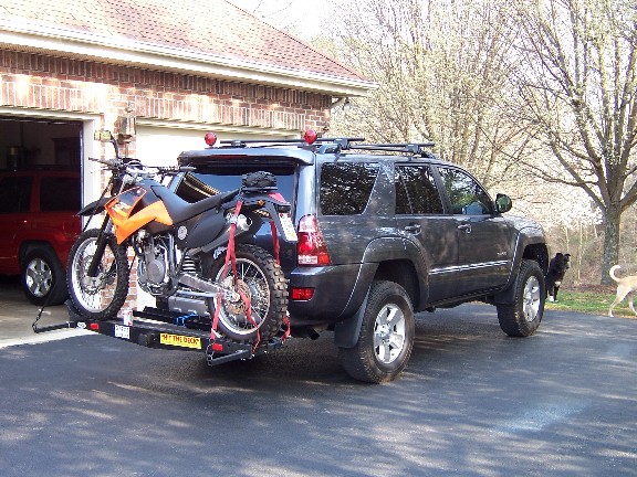

Don't tow but I do haul. The KTM is about 280 #'s and the Versahauler is about 50+#'s. So well over 300 just on the hitch alone. I have not had problems but did add some air bags to help the sag. Ran them at 17psi and at times forget there is a bike back there. You can see it sits more than level loaded. I do let some air out when un loaded to avoid the south of the border look.

I think airbags would have helped (where did you get yours from colemanfu?)

Flip - can remember the exact place I got mine but there are bunch of threads on air bags if you dig a bit. Try to put "air lift 1000" in a search and you should get tons of info. I think the site was airliftcompany.com? Good luck i love mine - bets $100 mod yet!
