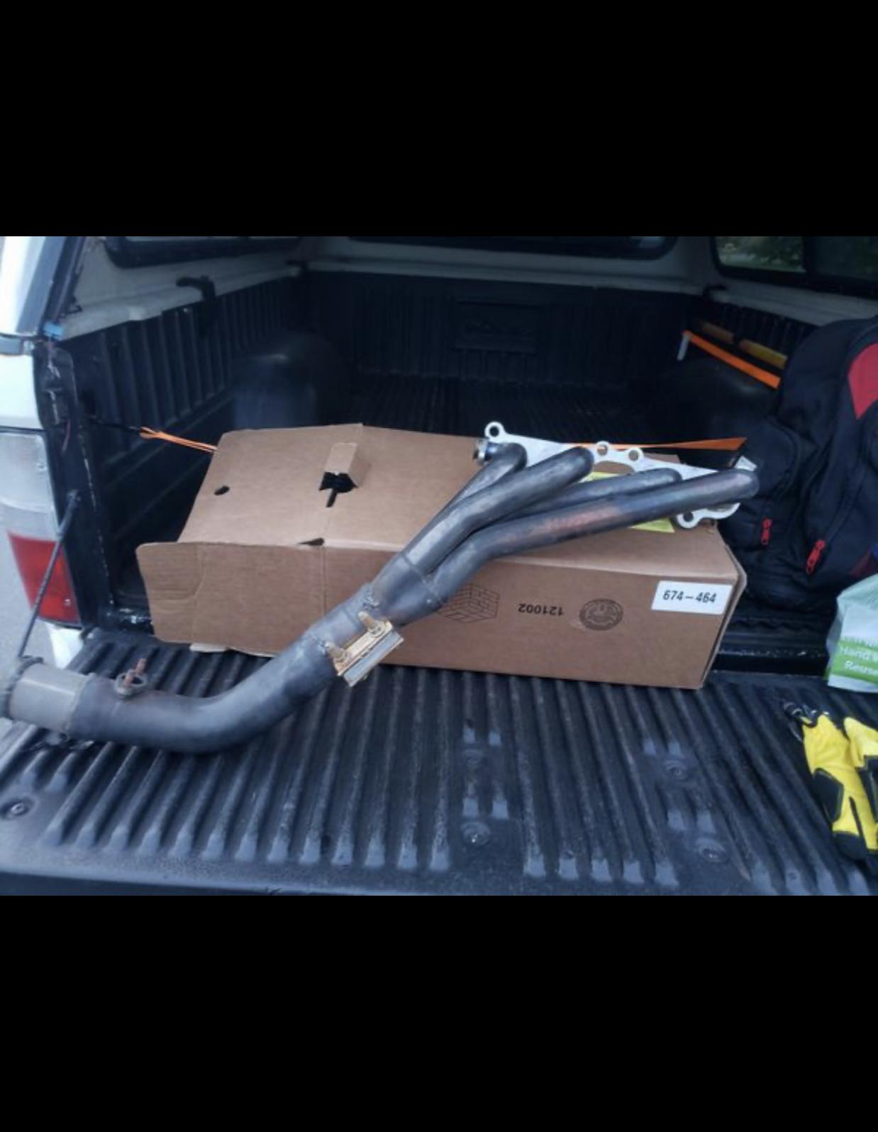

Damn I’m gonna have to go and take a look . Here’s what he’s selling not sure if this will help

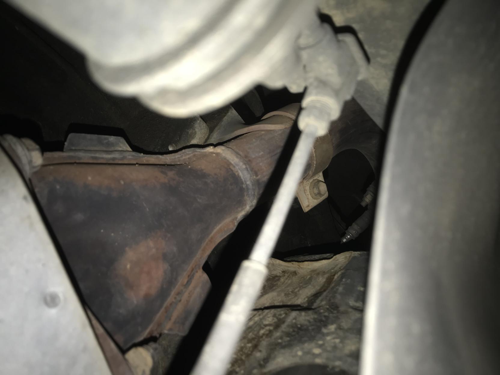

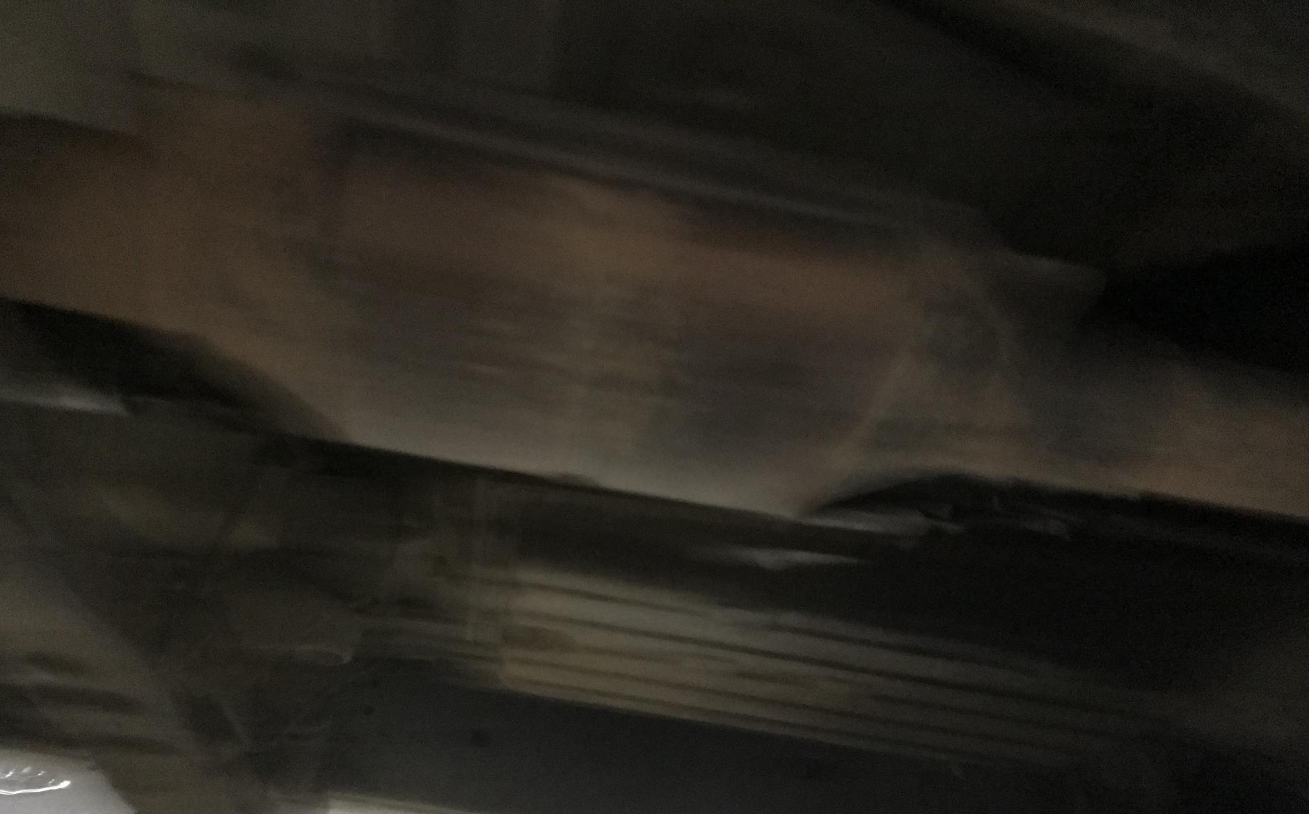

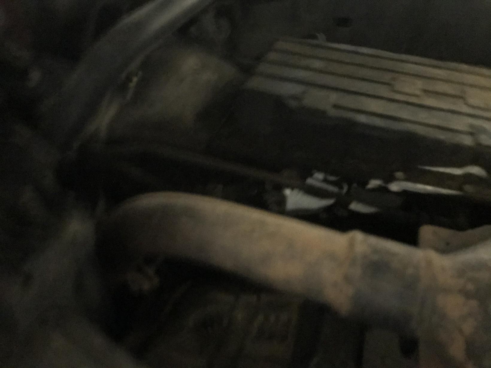

Picture of my down pipe to cat
Looks like I remembered correctly. On a Tacoma there would be a 2 bolt flange right in front of the cat and that's where the header would bolt up. Not a huge deal as any competent exhaust shop can add that flange for you to mate up the header, but that is added cost so you'll have to decide if it's worth it.
