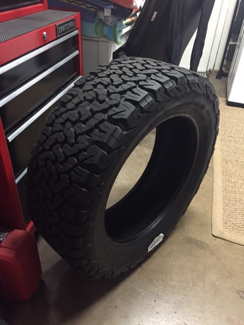

I've wanted to add a slightly taller and more aggressive all-terrain tire. Here are the parts I have sitting in the garage, but I wanted to run this by the experts before starting any work.
Tires: 275/55/20 BFG A/T KO2 (these are just shy of 32in tall. Even though these are only ~1.5in taller and 10mm wider, they absolutely dwarf the stock size tire when I put the two next to eachother)

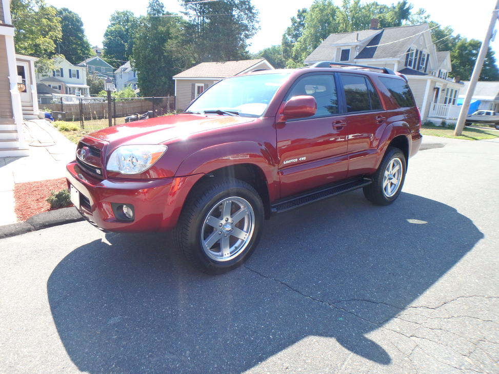

I have a '06 with a 2.5/1.5 lift, XSP rims a 275/55/20 Michelin Defender LTX . no rubbing, ft flaps still on. no issues. was going the BFG route but Michelin tire was lighter, more fuel efficient, better in packed down snow and come with a warranty. was also over 400.00 cheaper.
here is a pic:

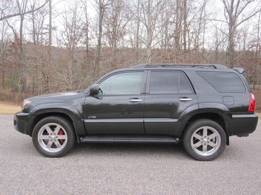

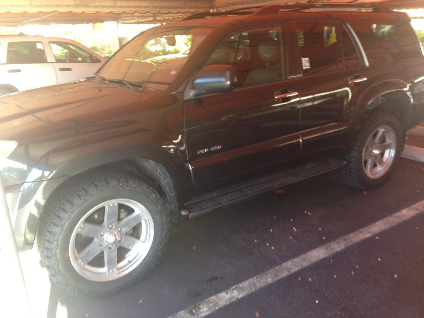

I had search a lot to do the same and i ended up using bilsteins 5100 at 1.75 in. in the front and using the original springs (coils) (I have neither wheel or suspension spacers and i have the XPS v6 4wd). i got level and the tires fitted well. i only had a minor rub at full lock in the front inner liners and the mud flap. So i did move forward the inner liner and modify a bit my mud flaps.
It rides well and i dont feel much the difference from the BF g-force i had before. (-1.5 gpm.) The only difference is that if feels that it bottoms out at the back when the truck is heavy and going to a bump.
The pictures are not the best but is what i got

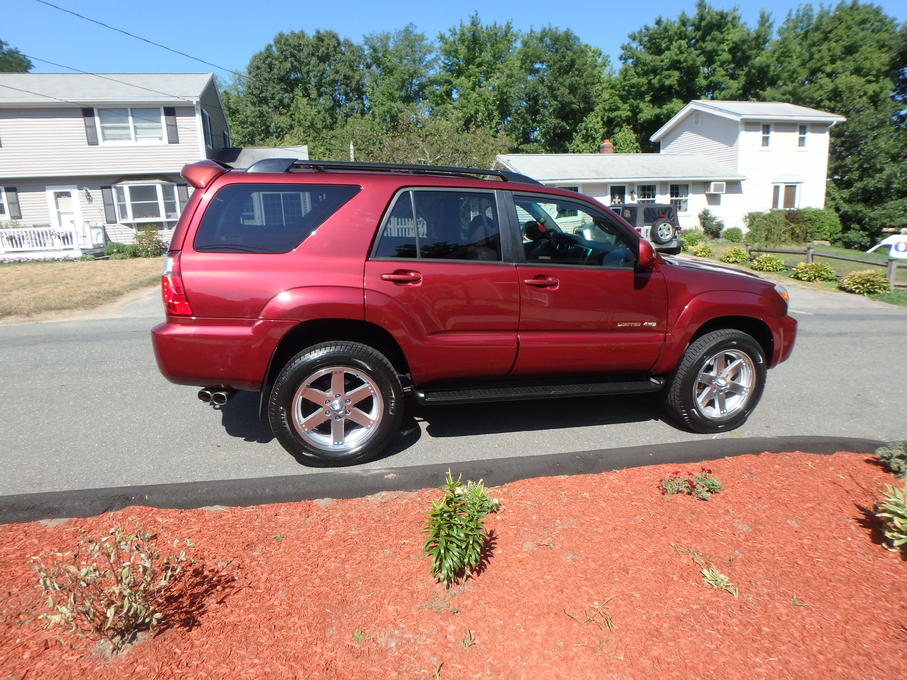

no spacers, I took them off for the XSP rims. they stuck out too far. with the 275's its flush with the flare.
I agree the BFG's are good looking but I chose function vs looks. I was this close to pulling the trigger on the KO2's. I had the KO's and they looked great but loud, horrible in packed down snow and I could watch my fuel gauge move.
here is a side pic:

Yes, they are 275/55/R20. I think i am the first one doing this tire/wheel combo on this forum. I really struggled to find out if they would fit since there is no much info in this or any other forums for 20s and K02 unless is a 5gen.
I live in florida and for gas millage i can see a drop of 2 mpg. I barely hear the tires as our Borla exhaust is louder than the tires. I had the Mud terrains KO2s on my 09 tacoma and definitely the All terrain are way quieter.
If you really like beefier tire and all good around just pull the trigger. It would look good and be functional. I believe , if you lift your truck 2.5 in. istead of 1.75 in as i did, you wont have any rubbing at all.
