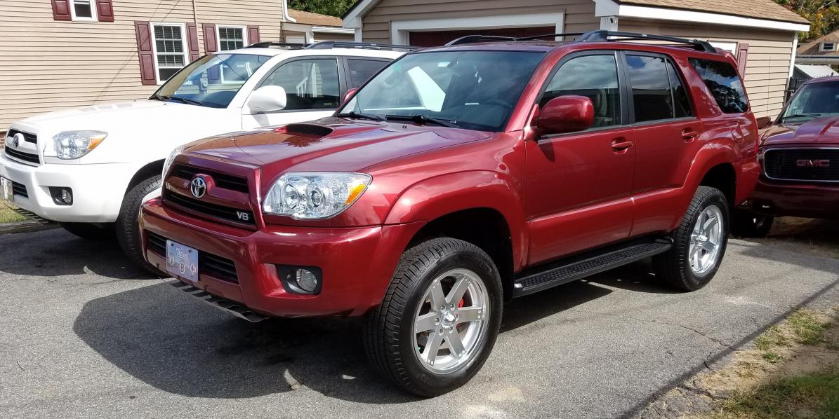

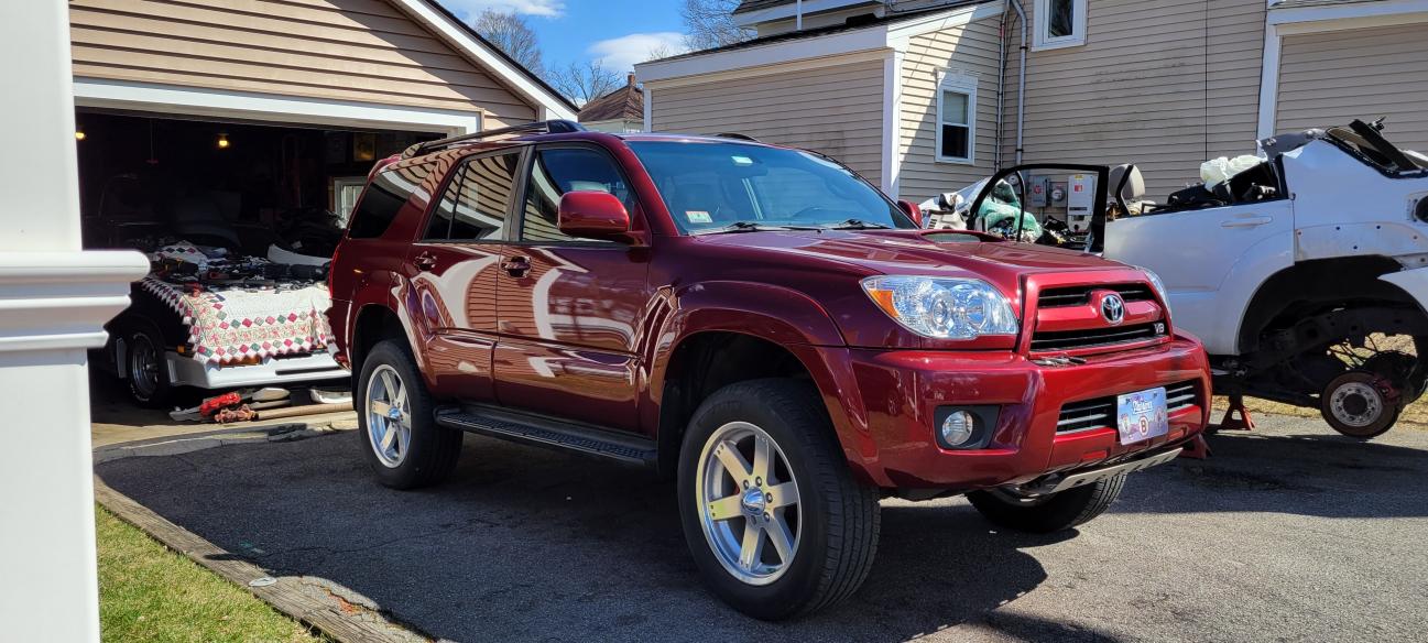

Hi all. I have a '06 4runner lifted with bilstein 6112s and 5160s with b12 coils. I have 4runner XSP 20" on michelin 275 55 20. The tires are dry rotting so I am looking at 275 60 20 grabber atx's to fill in the gap I have in the wheelhouse. The 275 55 20 fit fine but not sure on the 275 60 20 with the blockier tread.
What do you think. Here is a pic of what in talking about. The rt side pic is current within the past month or so.

are you rubbing/close to rubbing anywhere? I'm assuming this is a street rig that won't be articulating the front suspension to it's limits and we're talking a whopping 1/2" difference in radius here.. so take a look and see. If you're not rubbing and have a 1/2" to spare all around then yes, they'll fit
