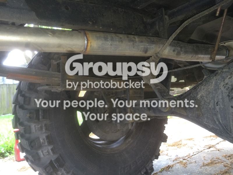

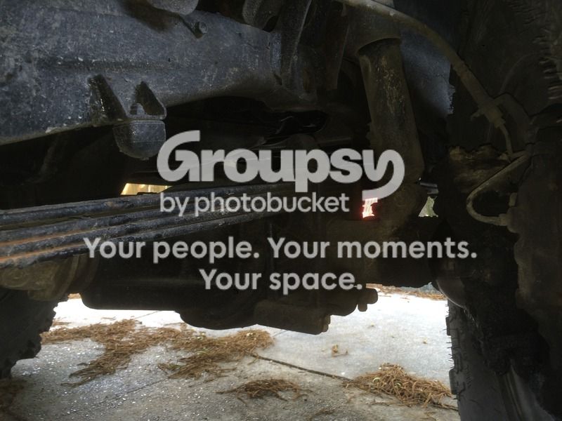

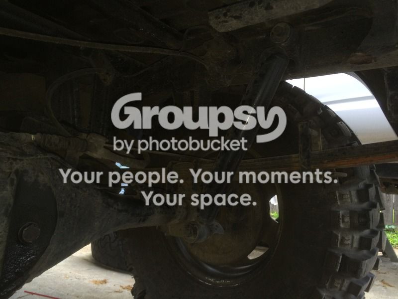

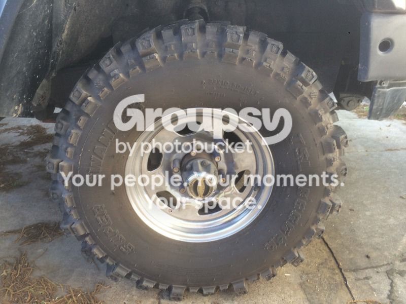

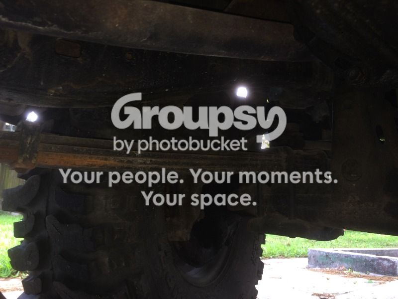

Ok - here are some pictures of the wheels and springs. The front springs actually look like they have a negative arch. The rear wheels have Toyota center caps. Not sure if that makes it for sure.

Your lugs on the tire are going to rub. Lift it and be done. Springs are cheap
Haha. Those things are ridiculous right? Again courtesy of the PO.
I guess I should change the title of my thread to something more refective of the feedback I was looking for - done. Yes - I would like to lift it.
