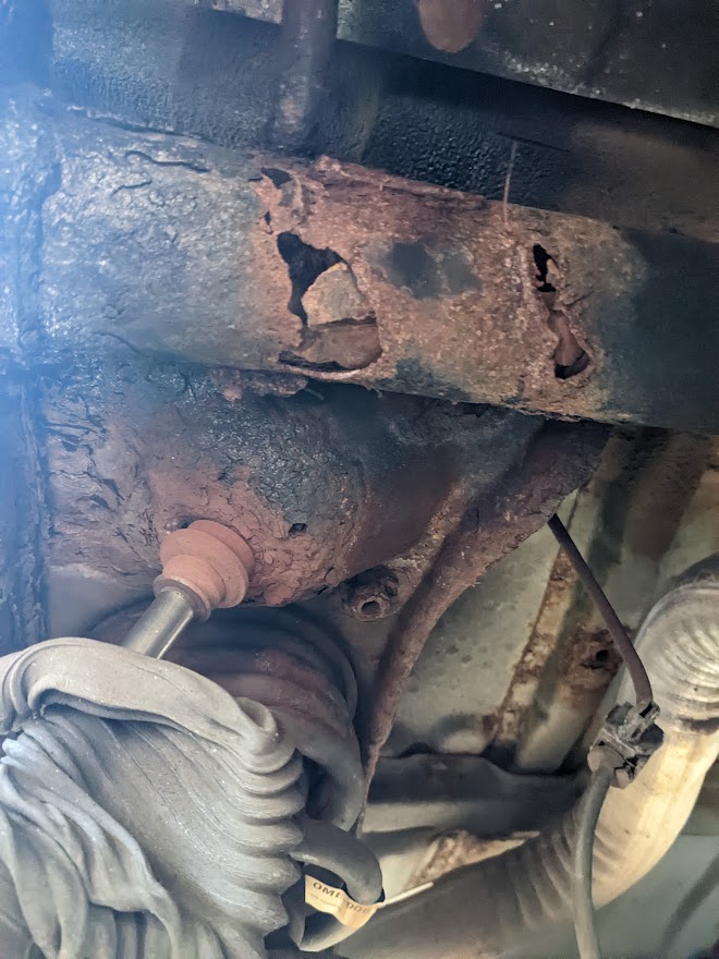

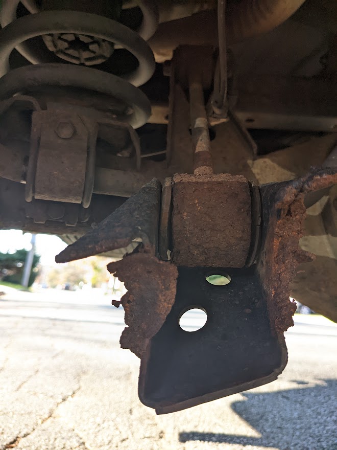

Well, unfotunately the weld didn't hold. Went to check up on this during the week and saw the control arm just hanging there.
Might try inserting a pipe and welding or scraping the truck.
What would you guys do?

I used the above mentioned Lower Control Arm mount frame sleeve on my 97 and it’s was worth every penny.
I clean out the pipe slide a steel thick gas pipe though and weld it into place. I also fill it with fluid film and seal it off. I cap off those tubes to save the new replacement pipe.
With a replacement pipe in there. You can weld the thin old pipe rusted through areas up and grind smooth.
If you want to keep it. I clean that stuff up especially those coil plates and coat and try to slow the rust down...:)

The bracket is still decent. So just put it in place. Use the steel gas tube and weld it back on. :-)
Be good for a while. You can even drill and bolt it back on then weld too.
I have had them even rust off the axle housing... :/
I just wanted to add on how to fix from my previous comment. :-) Hope this helps.
The reason the weld didn't hold is nothing is left on that area of the pipe is all.
I have one that did that .. :-)
