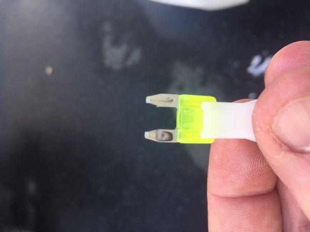

Edit: just pulled CKT OPEN and EFI relays, no issues with pins. EFI 30a fuse had issues as shown in pic, replaced.

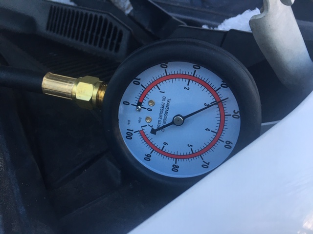

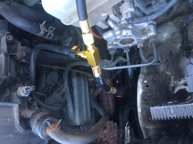

Update: the fuel pump test kit arrived today, hooked it up and found 43psi steady at operating temp and held ~26psi after shutdown for 2 minutes. Shop manual said 5 minutes but at 2 it wasn't dropping any further. I don't have long cranking to start, so post-shutdown pressure holding isn't an immediate concern.
I'll run another test in the morning cold since that's where my problem was/is.

Update: cold fuel pressure test showed 43.x psi steady, 26degF ambient temp. Fuel pump is ruled out as cause of problem.
