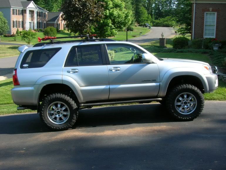

someone just added these wheels with a +18 offset.
Ultra Wheel - Gauntlet - Matte Black
20x9"
Offset +18
BS 5.71"
20x9"
Offset +18
BS 5.71"

i think these look a lot better the the FJ bbs. I've seen them on a friends tacoma. I'd try them but he has bigger tires on his plus out of state.
I think our wheels are too narrow too and sit inside the wheel arches to much. This is a wider wheel and would push out nicely if didn't rub in the inside.
