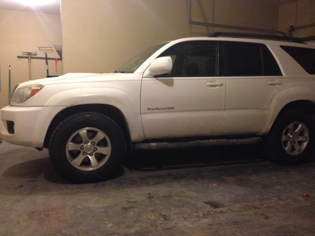

Sorry for the delay in updating; I had to go out of town and didn't get the coils / shocks until today. As bojanglesSR5 mentioned, I did get the 4Runner springs. Also, this is with 5100s all the way around, with the fronts set at the bottom notch (0.0" lift). No coil change in the rear.
Results for the front are as follows:
From ground to bottom of fender, before / after: 33" / 34"
From wheel center to bottom of fender, before / after: 19" / 20"
Disclaimers: measurements taken hastily, and went from 265/65 to 265/70 tires (Cooper AT/3).
Initial impression is that I should have done this much sooner. My X-REAS must have been in pretty bad shape, because I noticed a big difference on some bumps / train tracks that I go over each day. While the 1" difference doesn't sound like much, I think it looks much better. Below is a crappy iPhone pic to give you a basic idea.
