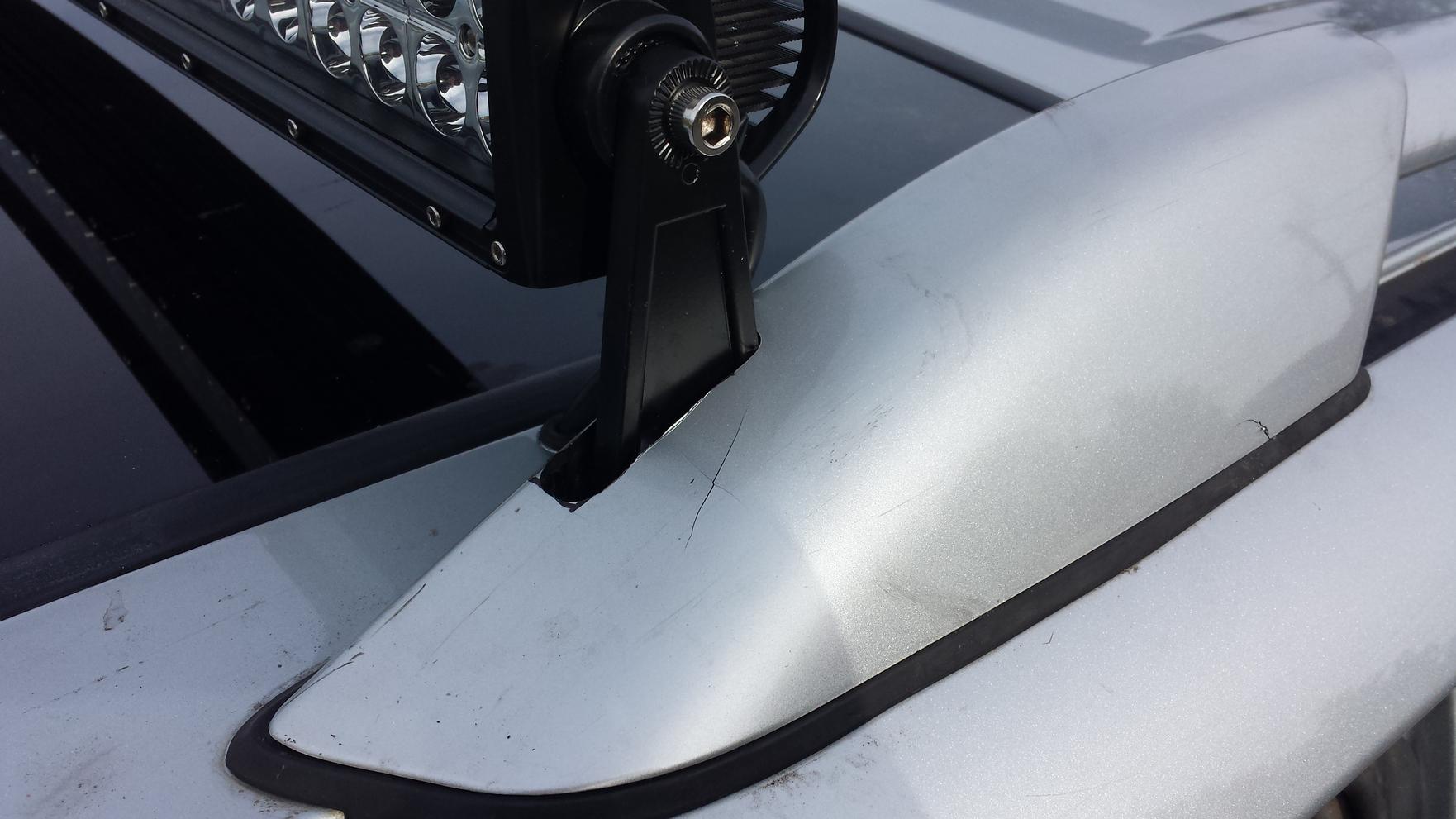

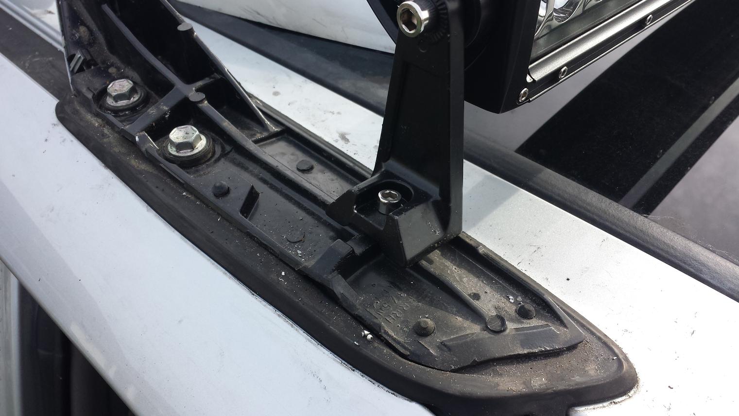

Can I get some pics of how you mounted the light bar?
I didnt take any but I just removed the rack cover drilled and tapped the holes in the rack mounts for the mounting brackets that came with the bar then cut holes in the covers slid them over the light bar brackets then bolted the bar to them. Sounds like alot but only took 20 mins
Pretty quiet kinda hear it around 30 and up but not loud. I drilled for the wire but drilled over the sunroof tray so if it did drip it would just run out the drains
Gotcha. I guess I wanted mine a little further forward and I wanted to not drill any holes so I did my way. I still have to trim the caps to fit them back on
