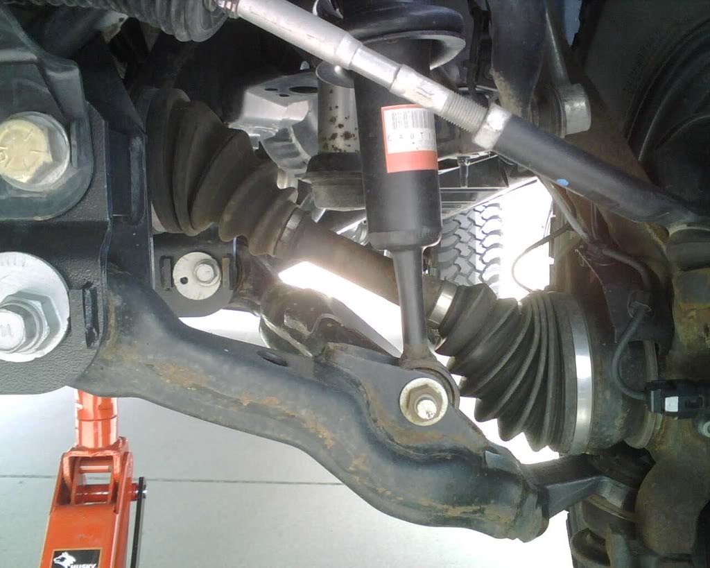

edit: i found a pic of cv angles on a 4x4 fj with a 6in, what makes me more concerned than the cv's, is the tie rod...

first notice that truck is jacked all the way up and that also may by why they added additional bump stops, also why would this be a disaster it works well on alot of the fj's its on its the same suspension.

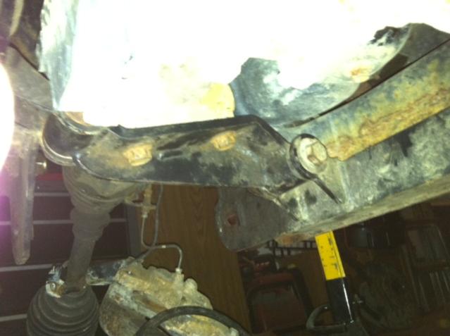

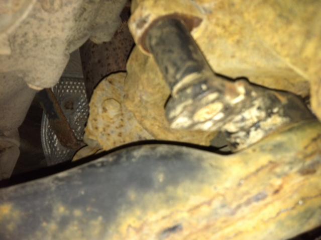

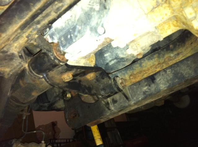

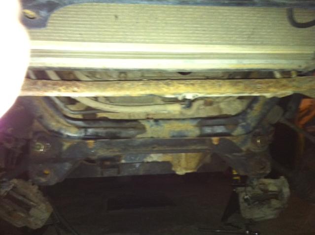

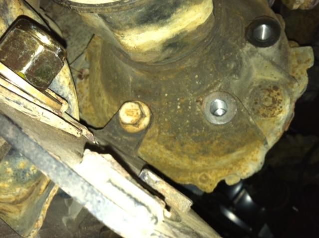

here are the pics lower control arms are still out because i need to press out the old bolts that had to be cut out. pic 2 and 3 are what lower and position the proper angle for the diff. and pic 4and 5 are how the driver side of the diff is secured. everything bolted in place as if it was ment to be.
