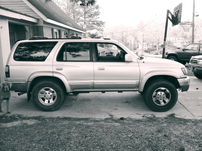

Driver Side Before

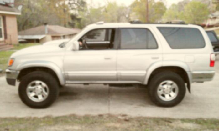

Passenger Side Before

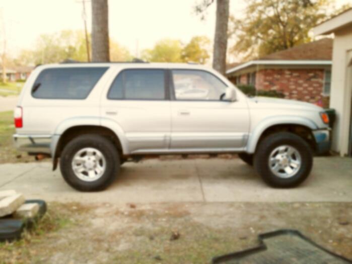

Passenger Side After

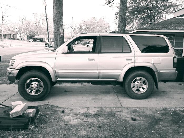

Driver Side After

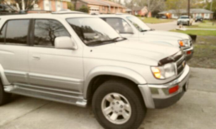

Beside my Wife's

I would really like to thank Chisel for the front and rear shocks, SMEE for the rear FJ coils and Death Cougar for the rear axle. You made all this possible!

It is softer in the rear but firmer, especially when loaded. When I hook up my trailer with the four wheeler, it still sits pretty much level. It doesn't knock my spine out thru the top of my head anymore. The rears are bigger in diameter and a there is a slight modifcation that needs to be made to the cone bump stop that centers the coil. I will get a few pics up of the mods needed when I formulate a permanent fix for it in the next couple days.

They are actually bigger in diameter. They are slightly taller and wire is alot thicker, much firmer ride but softer over the washboard roads and such, if that makes sense. I have to take them back apart to make a spacer that the cone bumper will sit into to center it in the coil. I will be comparing the top plates as well. I will take pics comparing the coil differences and the mods I use to get this fixed permanently. I am still researching some other options.
