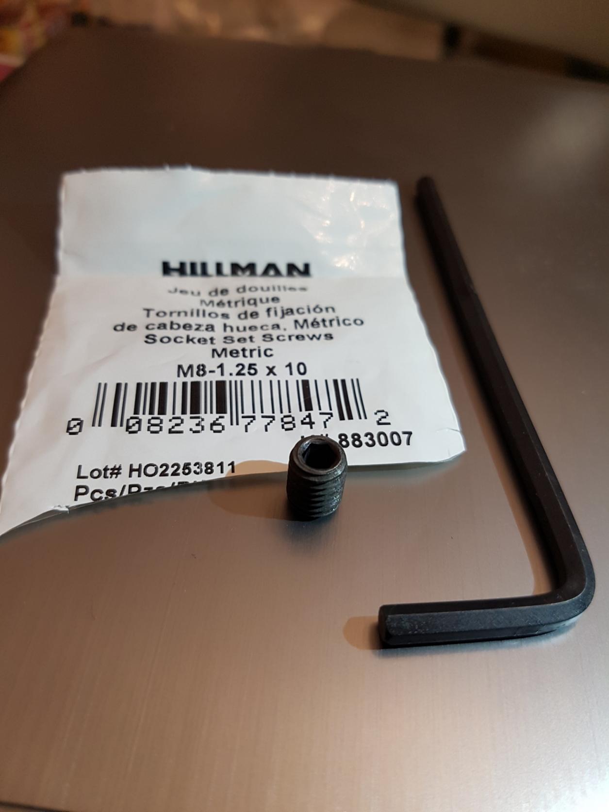

Instead of trimming the shaft or taking off the bottom piece of the shift knob, I simply inserted a socket set screw into the shift knob prior to install. It gives just enough space to clear the side of bezel/console when shifting out of park. I used socket set screws, metric M8 x 1.25 x 10mm purchased from our local hardware store. Cost under $2.00 for 2pcs. (only 1 required for this mod, allen keys not included).

The issue is when you shift out of park. The bottom of the shift knob hits/rubs against the bezel/console.
I went with a 6mm set screw. I’m guessing anything longer than 3mm would suffice.

I'm just chiming in to reconfirm that this mod works beautifully. I ended up using an M8 - 1.25 x 8mm set screw (it's just what I had on hand). Worked perfectly.
I originally planned on using a dab of red Loctite, however after seeing how easily the stock shift knob came off... I didn't bother.
