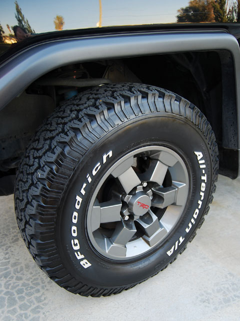

I have always likes these FJ wheels. Will they properly fit a 4th Gen?
I thought I read somewhere that the backspacing was different, but I can't find the details.

Many have done it... The 16" rim will NOT fit a SE or Limited as they have 13.3" front rotors. The SR5's have a 12.6" rotor and FJC 16" rims fit fine. A FJC 17" rim will fit any of the 4th gens. The offset is 15mm less than the stock rims. In other words the wheels sit 15mm farther out on each side for a net gain of 30mm of track.

I second that.
Good Luck finding those Gun Metal 16" TRD FJ Wheels.
