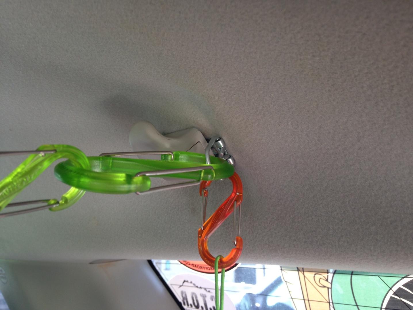

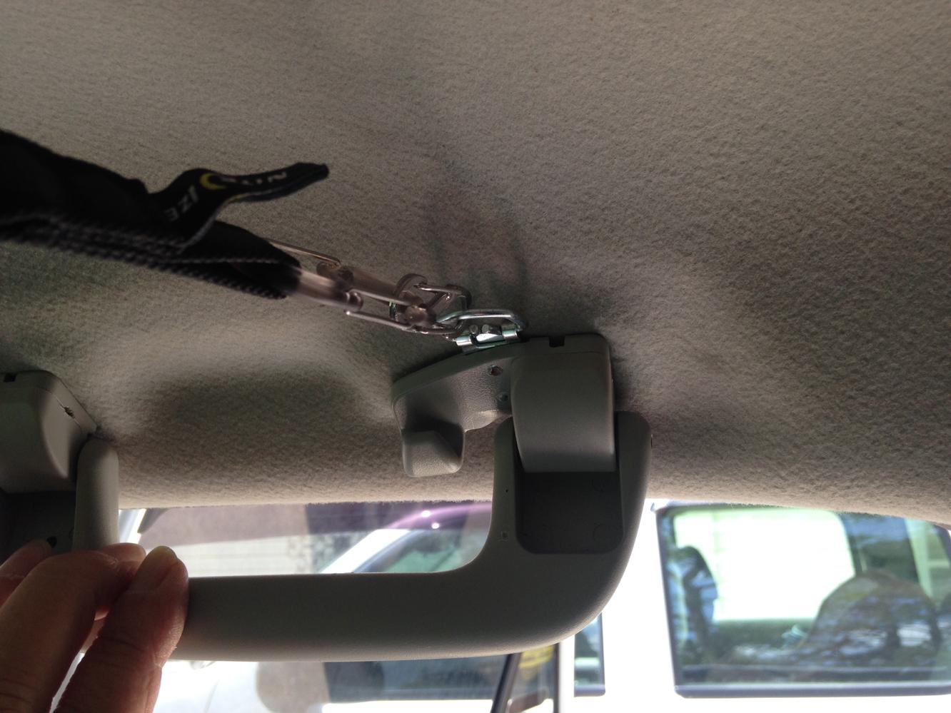

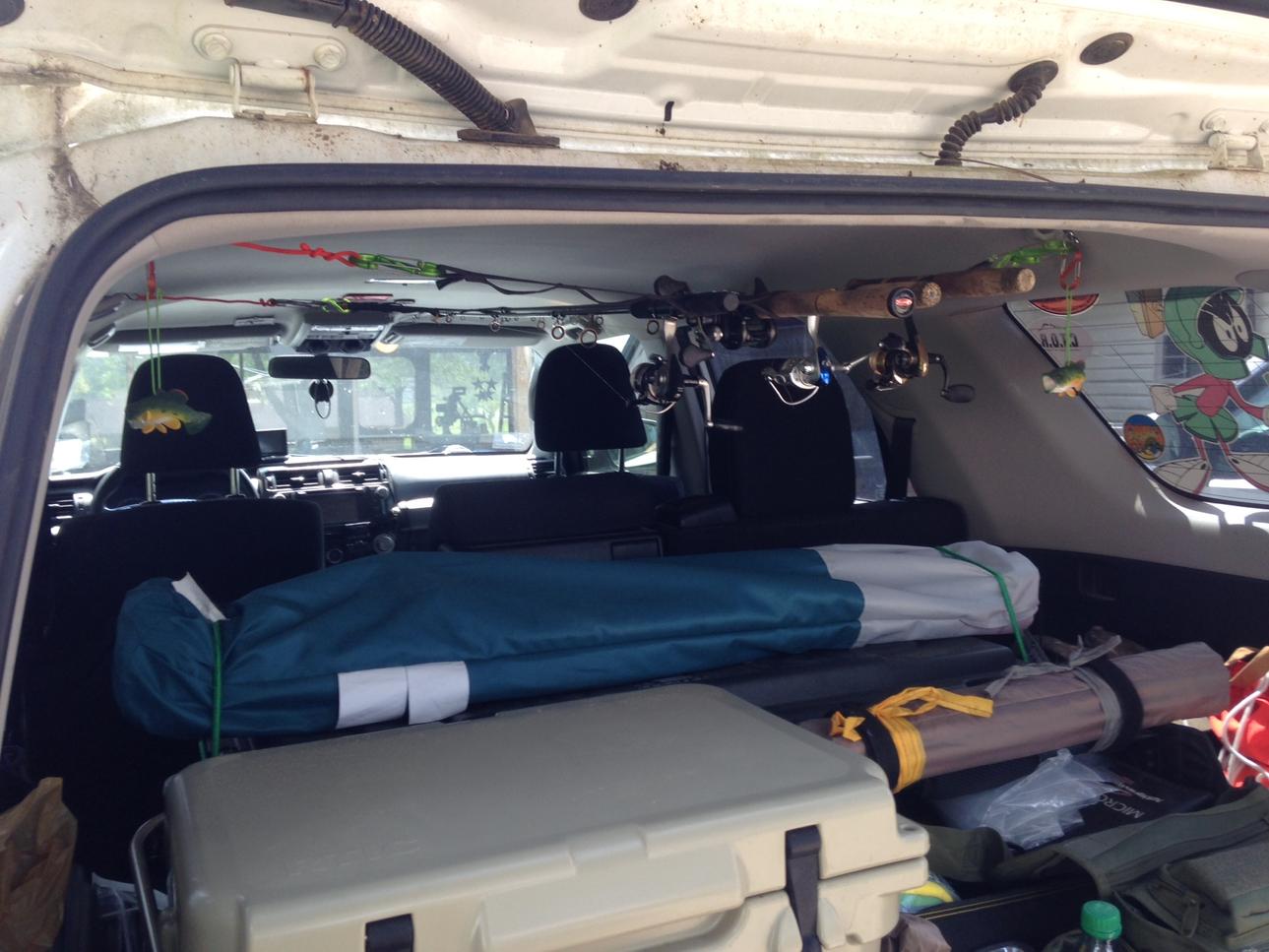

Or you could do this. I bought a set of 3/4 or 1" d-ring picture frame hangars at Lowe's and used the stud under the current rear hangar slipped through a screw hole in their plates to anchor them in place. So I have both in there. I use them and a similar setup on the passenger area handles to hang my fishing rods.
This is great. I don't need anything fancy, just wanted to string up some sort of cargo net for wet weather gear, etc...
Thanks!
