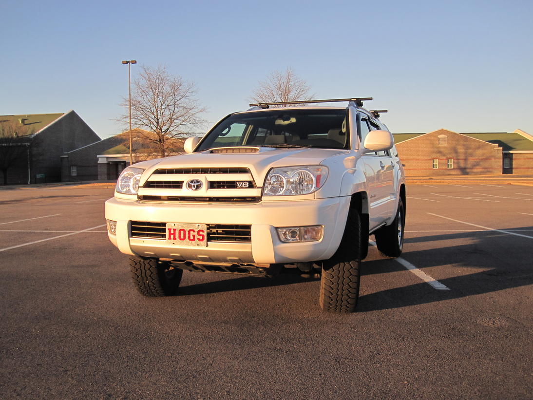

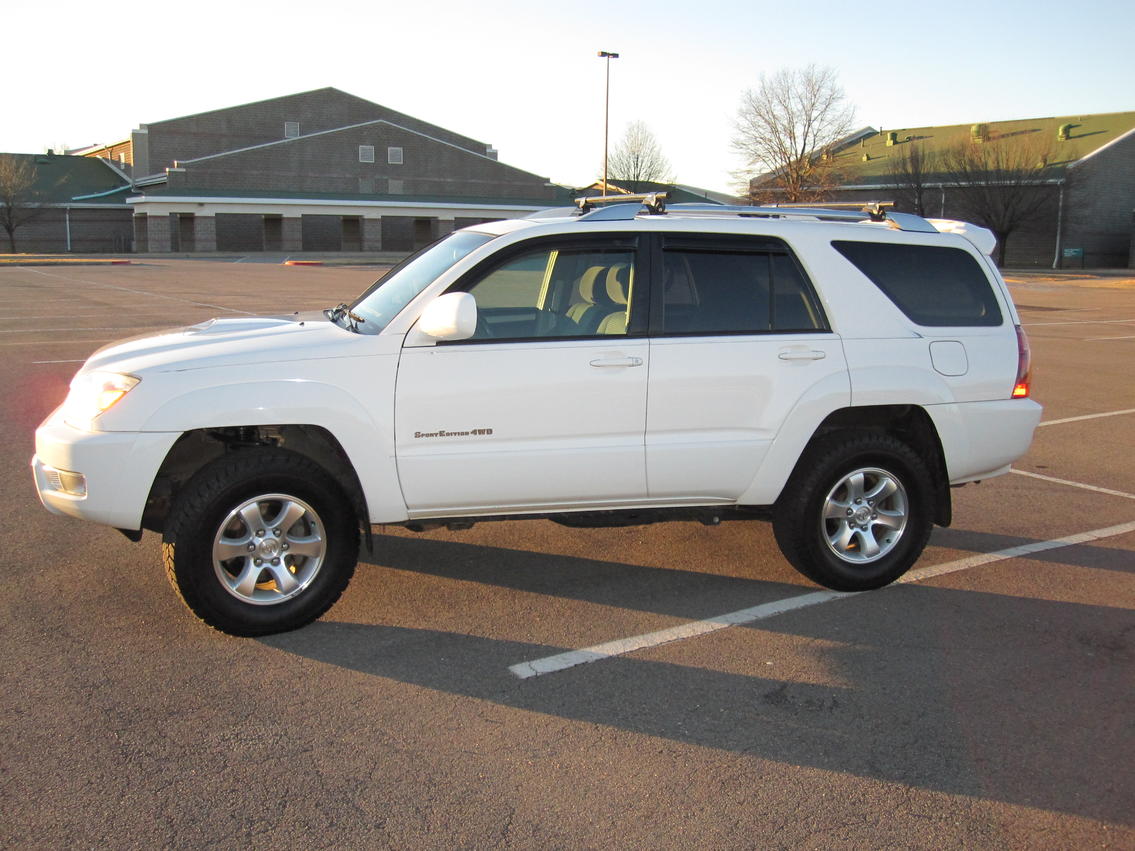

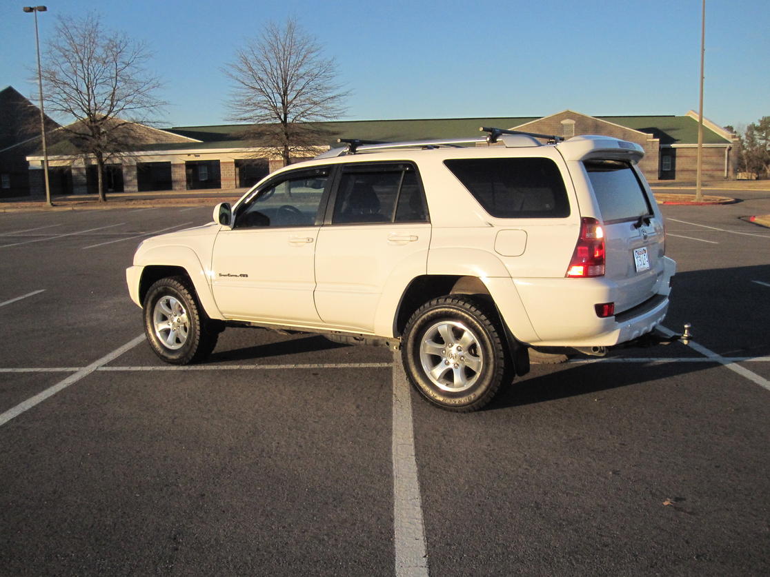

Picked up my 05' Sport 4x4 V8 from the shop Friday and man do I love the new suspension! Smooth as silk, yet firmer ride as the shocks compress more. I failed to measure the front ground/fender distance before, but looks like the drivers side is right at 35" and the passengers side is 35 and 1/4". I used the .85 setting on the Bilstein's. Not sure how much lift I got in the rear as I've had the FJ springs on there for a while. I can tell you it got rid of 90% of the sag when I was loaded down and I would guess 1/5" total w/ FJ springs.
Total install cost was $235 with alignment, plus $390 for the shocks shipped from Wheelers.com. Total of 3 hours labor to install.
Not sure why the color looks off white rather than "natural white"? But pics turned out ok for an amature w/ a crappy camera.

Looks good! In the first picture it looks like the front sits higher than the rear give you a bit of lean. Maybe it's just the picture.
-Jacob
Yeah, it's just the pic. The rear is a solid 1-1.5" higher than the rear, just how I wanted it. I like the raked look, just not as much as I used to have!

True but the steering wheel is off-center. It'll lift up on whichever side is turned out, especially with the swaybar still hooked up. Try it on yours:D
I didn't realize that it would lift that much. I might just have to try it out.
