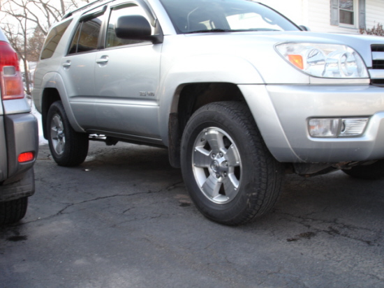

i installed fj cruiser front springs today. the truck sit really nice im super happy with it. took me about 1hr and 1/2. no problems at all. i work in a shop so i have a spring compressor. i measured before and after . the springs gave me about a 1 1/2 in of lift. leveled out nice. i will try to post pics tomorrow. this is my first time posting a thread. been on here a while looking and learning. i really love my 4runner. i have had a couple , but this is the nicest. got the prings on ebay for a 1.00 plus shipping ( couldn't pass then up ).
Do you have a V6 or V8? You got a 1.5" lift in the front?
My understanding is the FJ springs give 0.5 to 0.75" of lift.
before a installed the springs i measured to the bottom of the flare it was 33" after i installed the springs and let them settle it measured 34 1/2"
Well, I'm sure it'll settle after a couple of weeks, too. But nonetheless, that's cool. What are you going to do in the rear?

What year? 2wd or 4wd? What kind of miles on your rig?
I too have FJC springs, I love them! The extra stiffness is just right to me. I have less dive while braking, better handling and it's never what I'd call "too stiff".
What's your measurement like this (center of the hub to the lip)? I ask 'cause this dimension eliminates the 'tire factor'.

im not sureright now. i really like the way it sits. i may try fj rear springs just to see what it does. i might just make the rear a little stiffer. the front spring really stiffened up the front. when i had them side by side. they were a little bigger , not much. there were definitly more coils. anyway im hoping to get old man emu kit eventually. im not a huge space fan. i have a spacer but im going to sell it. it is a 1" or 1 1/2" space , not sure. id rather lift with springs if possable. i have always used springs on my other 4runners and tacoma
i will try to post pics today.
i measured from the ground to the bottom of the flare. i really like the handling. did the rear springs do anything for your 4runner. do you have a v-6 or v-8

Mine is a 4wd, V6 non-XREAS.
The rear springs are great. The rear lifted minimally; 1/2". The FJC rear springs are exactly the same length as T4R rear springs. They just compress less when the vehicle is let off of the jacks.
The thing I like best is the FJC springs handle a little weight much better; less rear end sag and a better ride when loaded. When it's empty the ride is nowhere near harsh.
