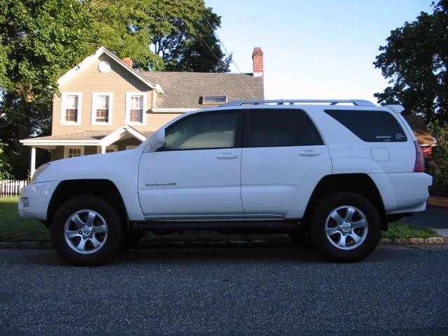

Here's a pic of my updated 4runner with the full FJ suspension and 2.5/1,5 Daystar comfort ride lift.

The FJ TRD springs, struts, and shocks, are definitely stiffer than stock. On my V8, the nose is down probably an inch or so compared to the back. The ride is much better but the unloaded back is a bit stiff..perfect for towing or for when you have 75+ lbs back there. It does not bother me since I live/work where there are really smooth roads. I will not put any spacers up front since it does not bother me and my gas mileage may go down.
I'll just decide on how level I want it when I do a full lift. I have never been a fan of spacers though, so I'll probably never use them.
Overall, the FJ mod is highly recommended. Stock (esp with the V8) there was too much brake dive and body lean. Also, it seemed like the springs compressed too much offroad. It felts bouncy and uncontrolled as well when making sudden moves. Maybe it's just the heavier-nosed V8 but I did not like the ride at all. Even 10% stiffer springs all around would greatly improve the ride.
