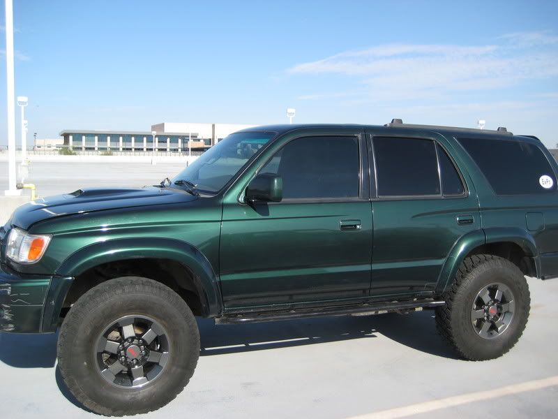

Thats what i was referring to. The 6 bolt pattern is correct. Those rims are 16x7.5", .5 inch wider than stock. The backspacing (per a friend that has them) is 5". Stock is 4.5. If you have wide tires you may have rubbing on the inside/a-arm/frame. Wide meaning 285+. Should not be any rubbing with a 265 or narrower. I don't know the b/s on the 17".
All Toyota 6 bolts rims are 6 on 5.5".
IMG_1313.jpg~original
will 265/70/16's fit on these rims?
in otherwords, the stock Wilderness LE tires?
if not, since its a 16 x 7.5-What should i get?
Where'd you buy the black/gun metal from?
