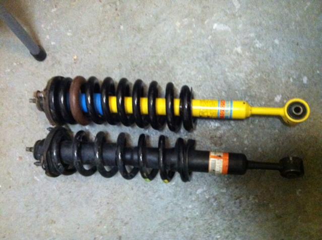

ok the tacoma springs are monsters next to fj springs. before i started from the ground to the bottom of the fender i measured 37 1/8, after i measured 38 7/8. front end is def. nose high. my rear measures 38 1/2. so looks like ill need some new spring and shocks. now with the tacoma struts and springs and a 3 in spacer your front suspension is def. maxed out. im hoping th efront end settles alil but not much since the springs are brand new and as for the rear bilsteins i hoped to use off the tacoma well thats def a no go the bottom holes off the shock are wayyyy to small.
heres a side by side of the fj spring and tacoma spring

Also can someone explain the rear shocks? Looks like they have a different bolt on the bottom than our 4runners?
