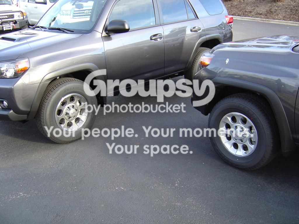

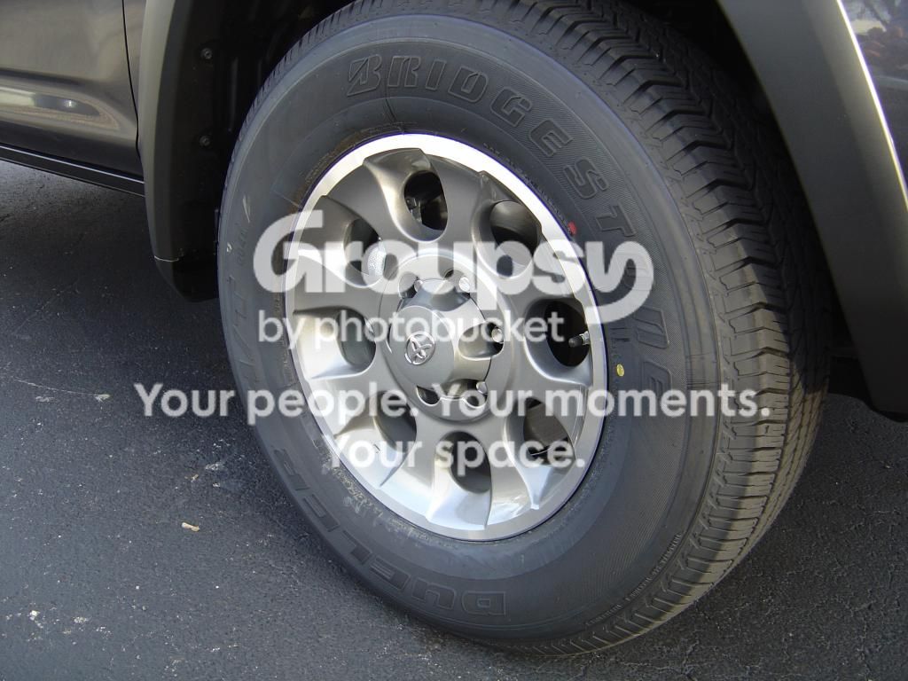

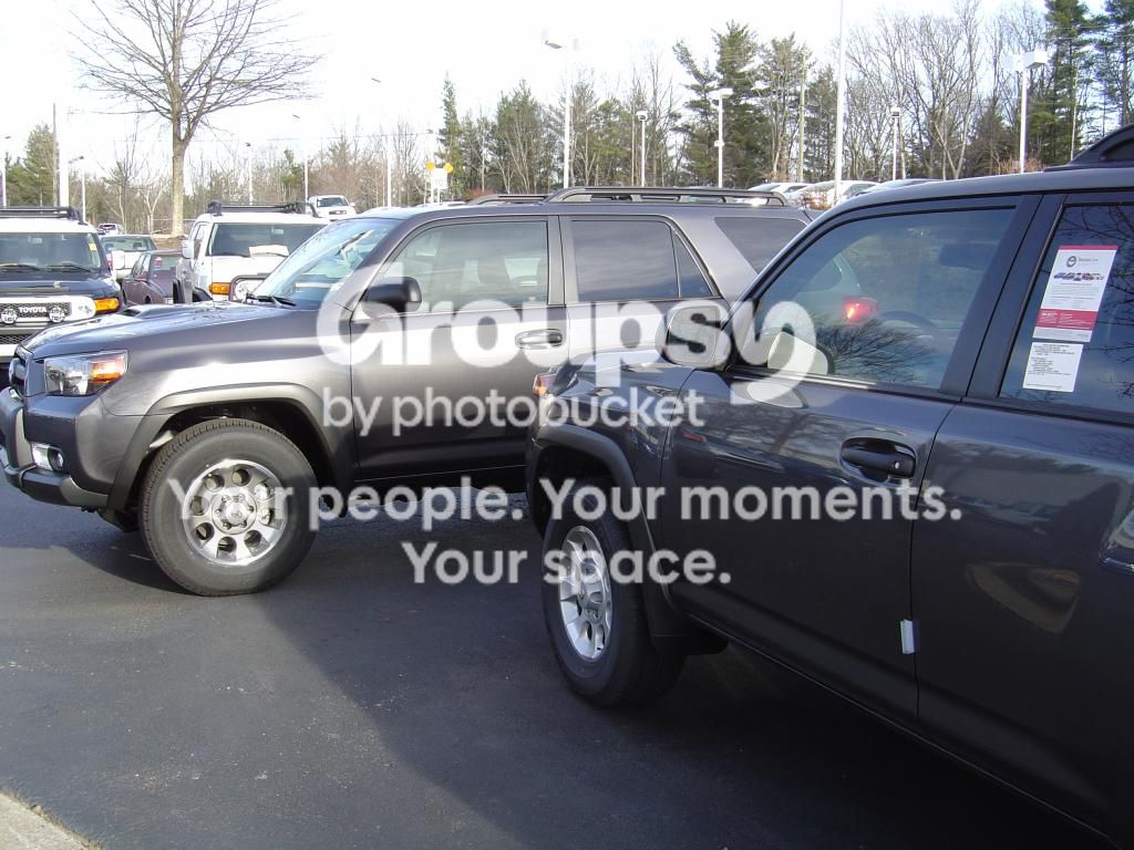

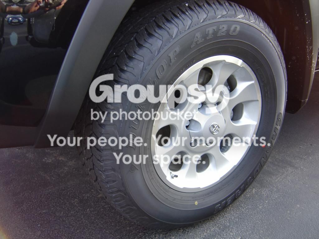

I wanted to post this simply as a reference for anyone searching in the future. When I was getting ready to purchase my Trail I researched alot to find out if these wheels were EXACTLY the same (backspacing/offset) with the only difference being the color. I read alot of conflicting information, but finally found enough to convince me they were the same. I can now confirm that they are the same. No differences at all.
I thought I'd throw in some pics as well.
Trail wheel
DSC03839_zpsab2351e8.jpg~original
FJ wheel
DSC03840_zps381bbfe8.jpg~original
Trail on a Trail
DSC03841_zps1782adfc.jpg~original
FJ on a Trail
DSC03842_zpsc58b9ac2.jpg~original
Comparison of the two. Both on MG Trails.
DSC03831_zps80ae2db7.jpg~original
DSC03834_zpsbd6ecde6.jpg~original
FJ's on Magnetic Gray
DSC03846_zpsb113d047.jpg~original
Hopefully this will help someone in the future.
look more closely: Bridgestone Duelers and Dunlop Grandtreks... same as it ever was... :violin:
Got it now, the Dunlops have a beefier tread. Everything in San Diego had the Bridgestones when I bought. I hadn't seen Dunlop AT as standard yet. Wonder if they are less annoying than the B/stones on CA freeways?

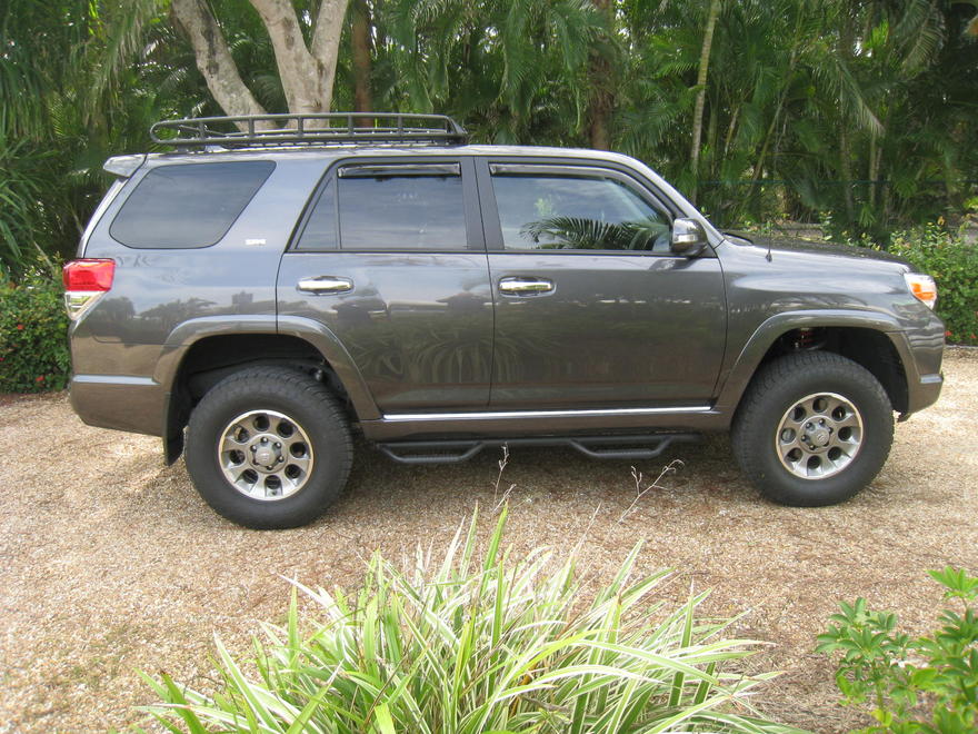

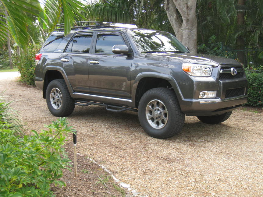

2013 FJ wheels on 2011 TR4 SR5
I just did this swap last week. So far I've had no issues what so ever, they ride and look great, and best of all match the mag grey! Woohooo!
