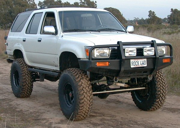

Here is the quote from the Marlin Crawler page and a photo:
Marlink Heavy Duty Tie Rod
Heavy duty replacement tie rod for your '79 to '85 Pickup/4Runner with stock steering. Custom sizes also available upon request (see below). Made from 1.25" DOM .250" wall tubing. The left end has a clearly visible identifying ring, preventing confusion as to threading. Each Marlink includes 2 FJ80 tie rod ends and jam nuts.
MC-13623, Marlink Tie Rod w/Ends, $127
By way, does anyone know if the bumper on this 4Runner is an ARB? It sure looks like one.
