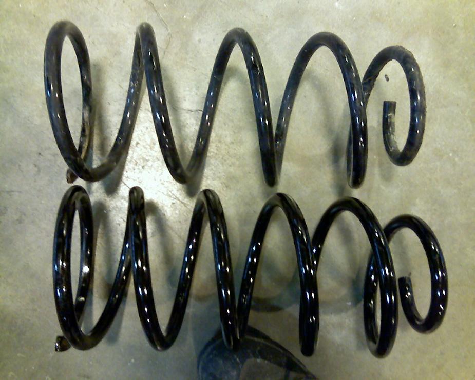

Here is a pic of the 4Runner spring next to an FJ spring. Rear.
That's exactly what I saw too... The metal is a hair thicker with a full extra turn and the same length...
The reason I am beating this deadhorse a bit is that I recently discovered a part# difference for the '03-'06 vs '07-'08. I was trying to figure out why. Is it simply a vendor change or was there a real difference? So far I am guessing a vendor change... Thanks for the pic.
