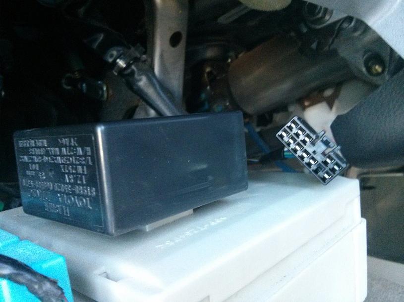

I just ordered one. In fact I'm waiting to ship it back. Apparently if you have the DTRLs it’s a different plug. The TapTurn flasher is for non DTRL 8 pin plugs. The DTRL vehicles have a 12 pin plug. After talking to the company they are going to drop support on the 4Runners due to different markets requiring different DTRL rules.

the lane change thing i don't care about, but there are several 5th and 4th gen guys that have been trying to figure out how to compensate for the rapid blink of the LED bulbs.
Probably different (I have a 3rd gen) but when I installed led turn signals I replaced the flasher relay with a Tridon EP 35 relay from autozone. It fixed the hyper blinking issue for 11 bucks. Any 4th or 5th gen guys try it?
I've tried.
Yes I have please view the 3rd post. It doesn't work.
I think [MENTION=73782]Slow_T4R[/MENTION] meant trying the Tridon EP 35 to fix the hyperblinking.
As for the TapTurn relay, thanks for trying. I was getting my hopes up. Oh well...
