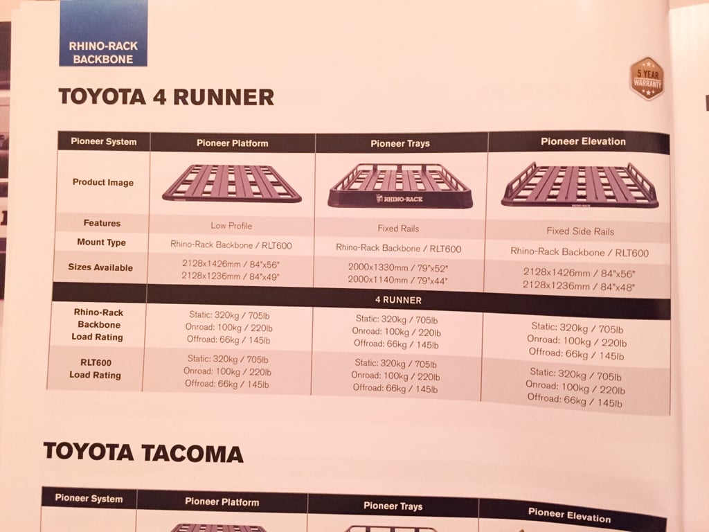

Rhino Rack Pioneer. Front-to-back slats similar to the K9 in design but with a rounded/aero shape around the perimeter. Uses tracks to install like the K9, but requires drilling and riveting. I can get a really, really good deal on this setup, but the website list the capacity at 220#. I weigh 220#, so that rules out an RTT with me in it. Maybe that's the capacity for a dynamic load?

The weight rating for the Rhino Rack at 220lb is when you are driving "on road". The weight rating "off road" is 145lb, with "static" being 705lb.
Source:
http://www.toyota-4runner.org/5th-g...ino-rack-rail-mount-system-2.html#post2519414
I got a copy of their 2017 catalog they were passing out at the show. See photo. I will reach out to the rep I spoke to at the show and get more release details. Post up any questions anyone else has and I will ask.
Source:
