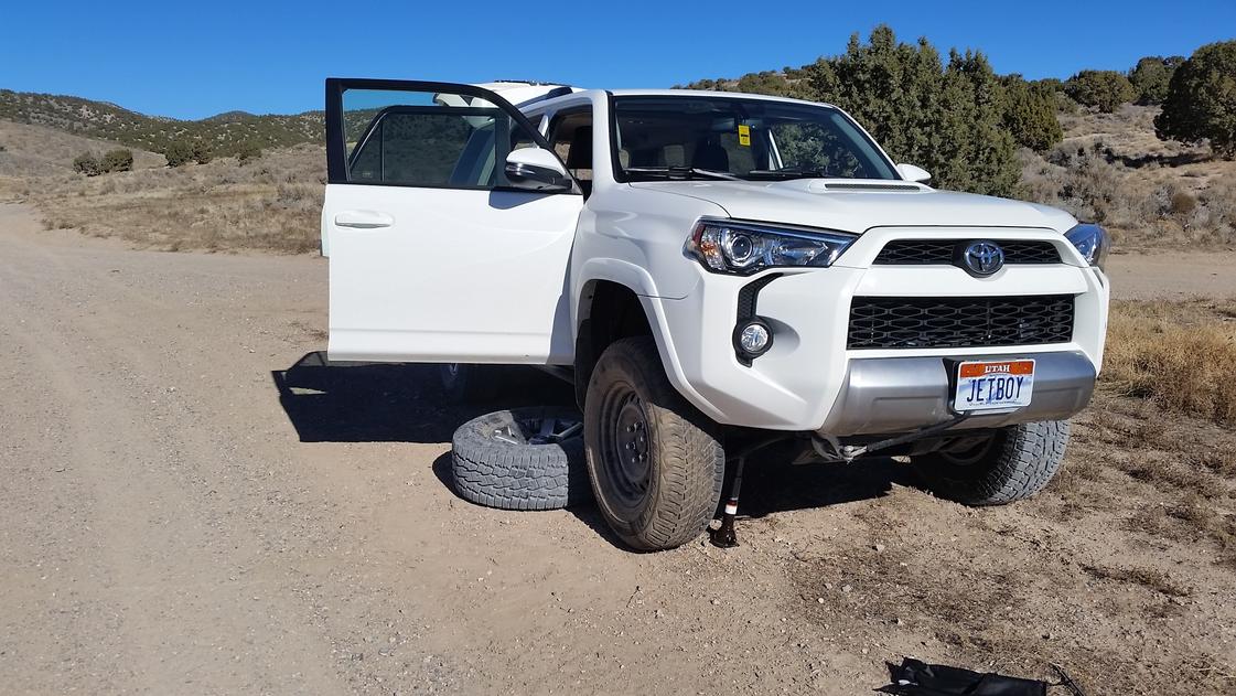

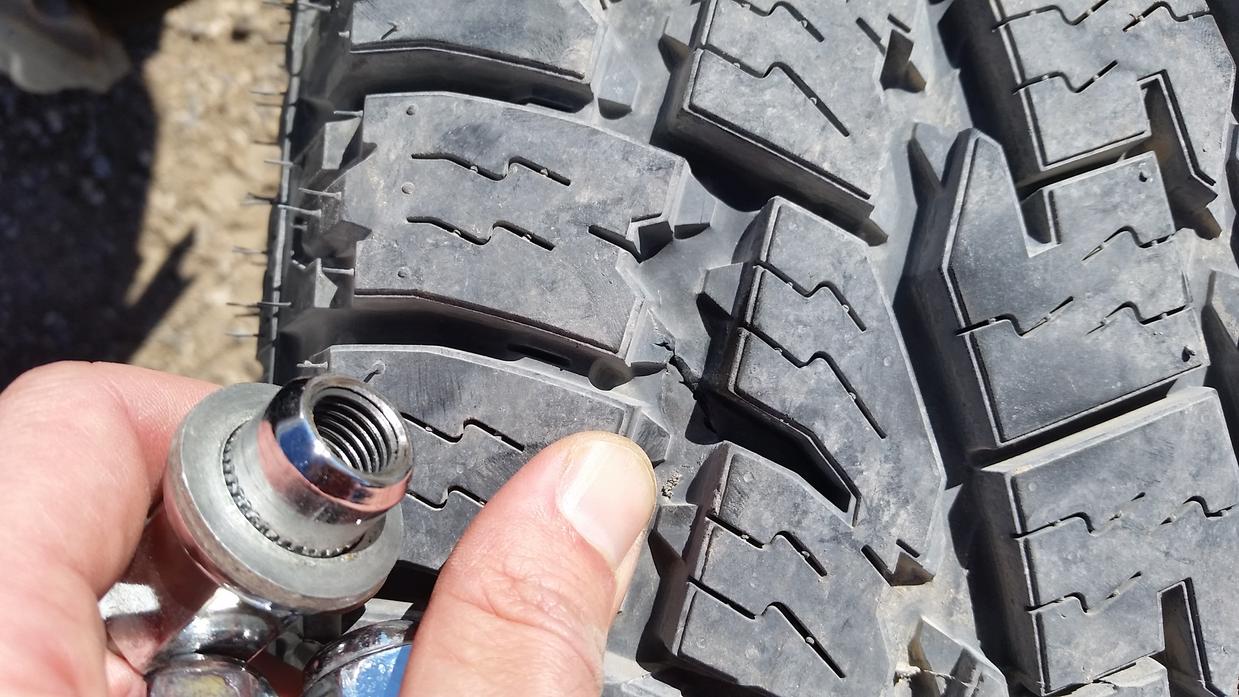

I had a flat on my BFG KO2 tire when out in the boonies in the mountains around Silverton, Colorado a few years back. Picked up a nail driving through a dilapidated mine site. When the low tire pressure light came on, I turned around and headed back to town. Unfortunately, it was a Sunday and all the shops were closed so I had to put on the spare. Better to do that on a hard surface than in the back country. As others have said, any tire can get a flat; you just have to be prepared with a good spare and the right tools to put the spare on when you are far from any service area or tow truck.

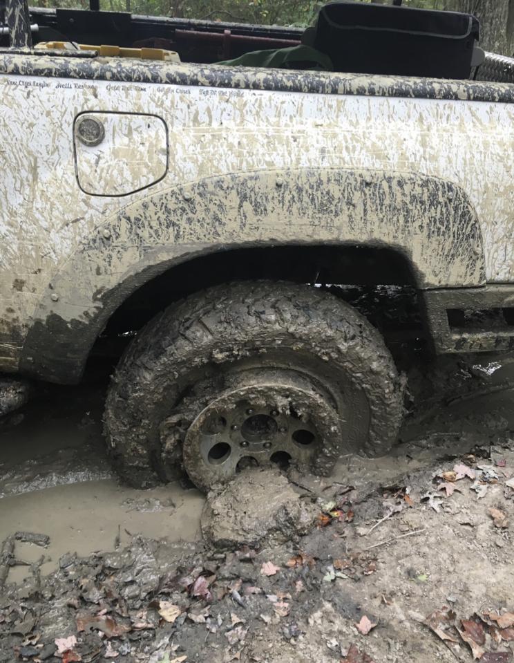

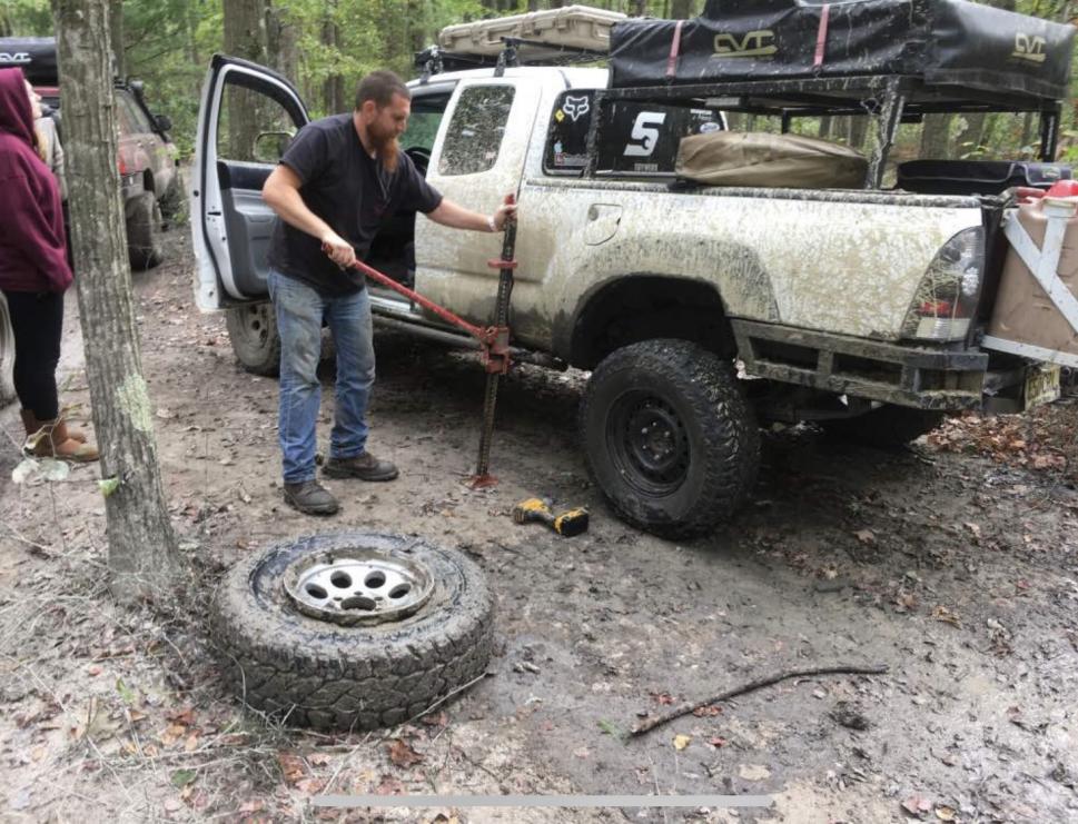

Nothing like some slop jalop and a highlift

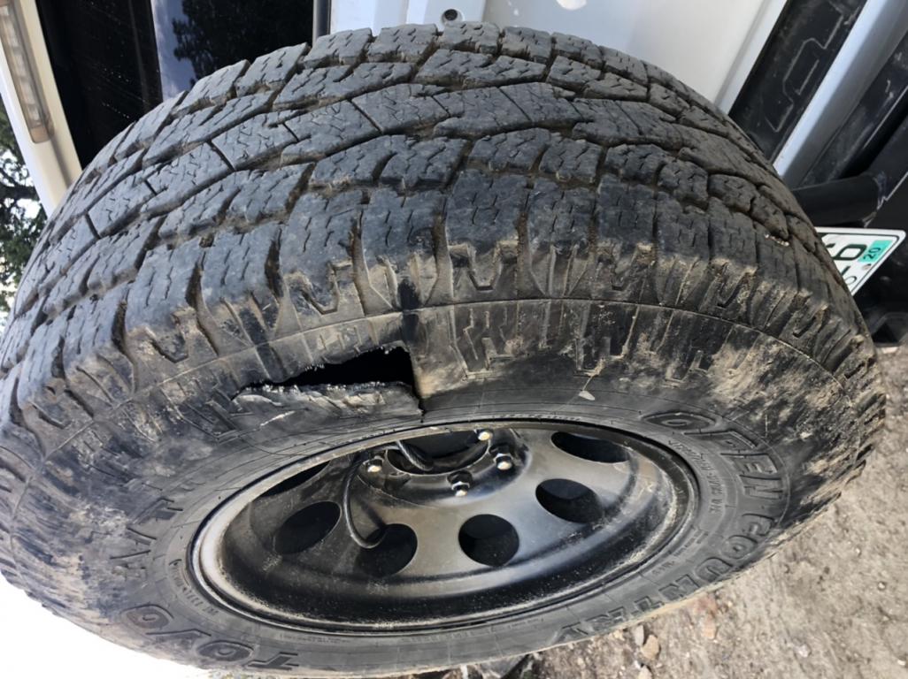

Blew up an AT II on a trail. Caught the edge of a buried pipe with the sidewall on Rollins Pass, CO. Was only aired down to about 25psi. Not a fun place to do a tire change. Very thankful for my tire carrier.
Otherwise the AT IIs were bulletproof even after 40k miles on the road and only had one leak patched from a scew.
