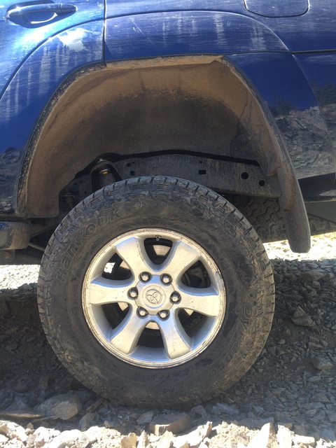

1st pic was my first flex....my husband laughed as I took all kinds of pics

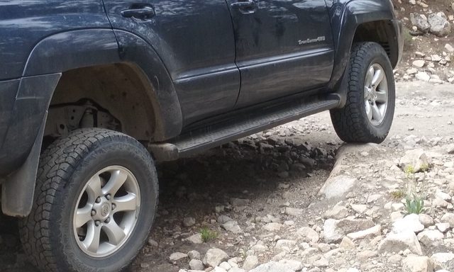

Wish I had gotten a better picture but I had people waiting behind me to go through.

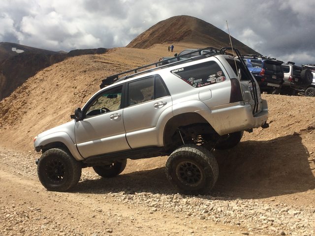

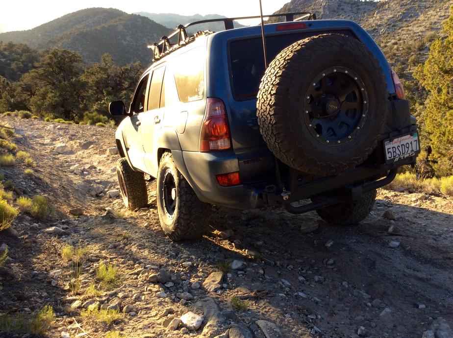

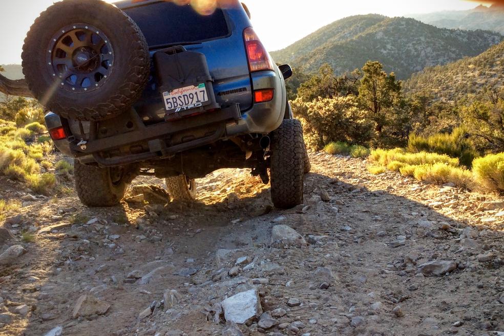

It was a mild flex, but I knew it was Friday so I flexed and stuffed a little!!!! It felt good to stretch her out a bit.

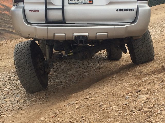

I flexed to the max for [MENTION=101553]t-man[/MENTION] on a Saturday...
My tire was just scraping the ground and I couldn't flex no more...

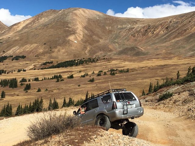

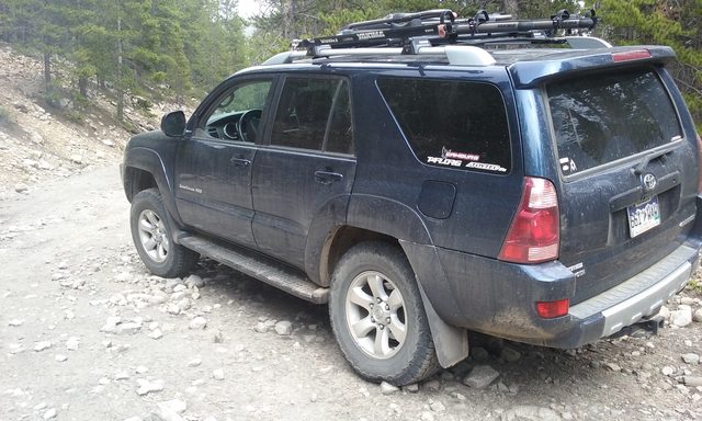

I don't know his T4R.org user name, but I suspect he's out here somewhere. Ran Webster Pass with this cat yesterday and I think this qualifies for flexing?!?!? ... and it got posted on Friday!
Just sayin...
Just sayin...
I believe that's "the skid kid" and I don't think he's on the forums. He has a web page and uses Instagram and Facebook mostly. He can max the droop on that rear end. The uppers will hit the gas tank.
