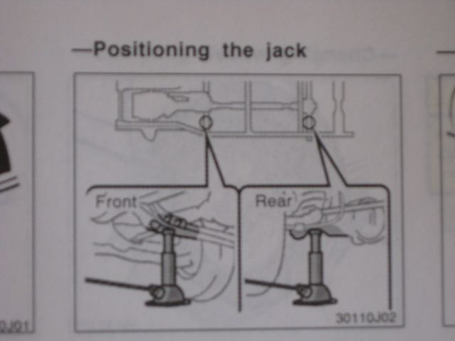

i think this is a good spot post this. i sure feel stupid for asking this and all those shop classes were useless but where are the jack points on a 3rd gen 4runner? i took my boards off and the only spot low enough is the stabelizer bar (in the rear) i had to even but boards under it to reach that. also if i was to get a lift obviously the stock jack wont reach it. what would you do? do you just haul this huge jack whereever you go?

hey thanks, ya ive got Owners manual but it shows to jack it by the running boards, but ya i took those off and i dont think id want to even jack it up with those. thats just crazy. so with a small lift do you think the bottle jack would still work?
ill take a pic of mine too. but ya it was wierd i just noticed this but the guy that installed my wheels (i think it was them) jacked it up from the braces on my nerf bars and one bent a little as well as takin a chuck of paint off. i duno?
Photo of mounting points
Here is a photo from my manual.
It appears the front location is on the cross-member of the frame.
The rear is under the rear axle.
