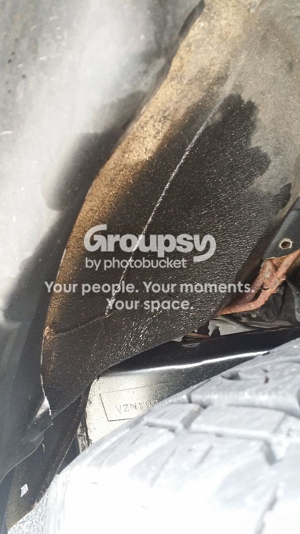

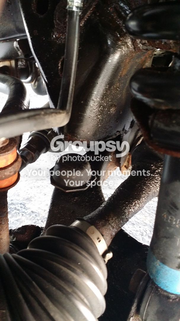

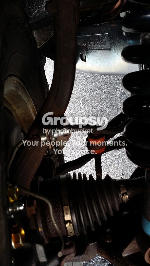

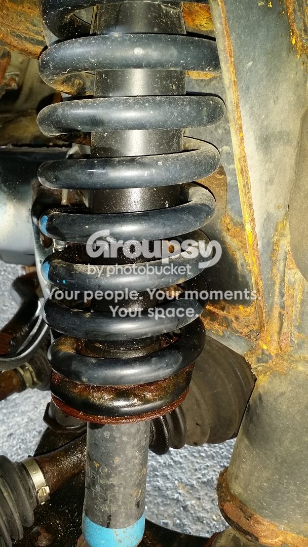

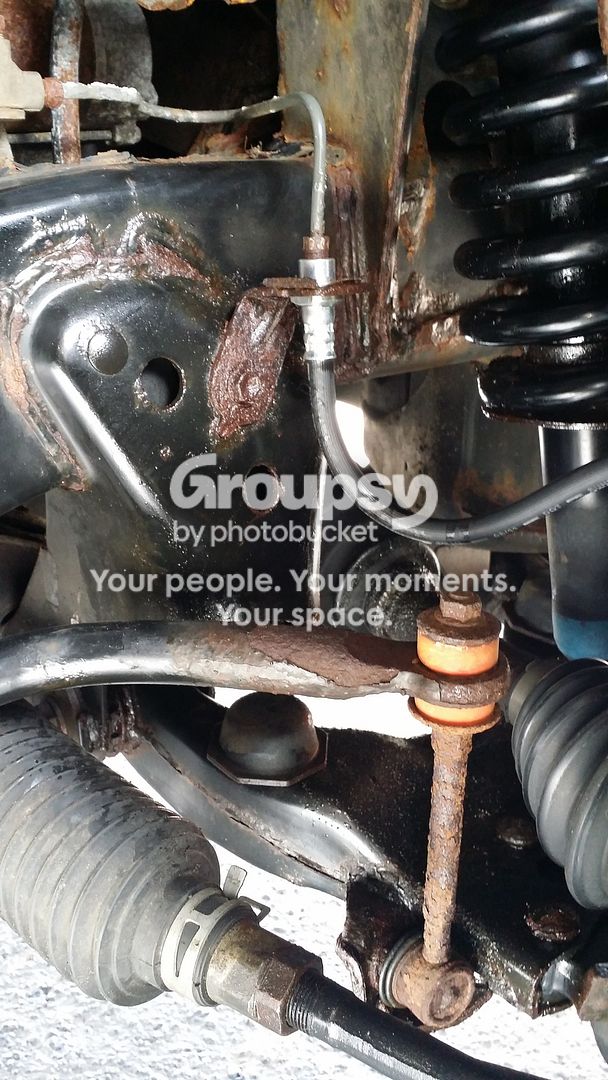

Finally have some pics.
There was enough fluid to pool 4" diameter spots on the ground and for it to be dripping off the frame by the cat. Its no longer pooling on the ground but everything is still wet. Brake fluid level is still the same.
Its clear, thin, doesn't smell like gear oil, ps fluid or brake fluid. Rack is dry at the boots. The only thing left is shock oil.
I wanted to call you crazy for saying shock oil, but I don't know how else your shock would look so wet. If the PS reservoir is at consistent levels, I guess the shock is your culprit
