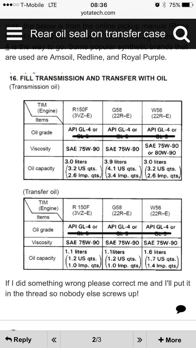

The 5 spd uses 75W90 GL4 or 5. About 3.5 qts.
The t-case uses about 1.5 qts of the same.
The diffs use 90W or 80W90 (easier to find) GL5, about 4.5 qts total.
Brake fluid is DOT3 or better.
Your choice of coolant color.
Power steering uses ATF.
Here ya go!
