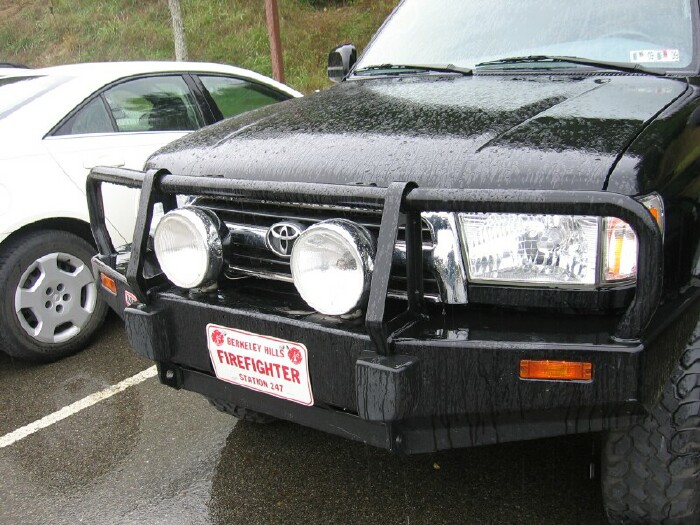

I really like IPF lights. They are really good quality. I've had other brands like Narva, KC and other cheaper stuff and they have not lasted long at all. The reflectors are lousy and start to bubble and flake and plastic components fade and crack after a year or two.
My IPF's have 130W bulbs so they really light up the road. (I wouldn't bother with any bulb less than 100W)The housings are all metal and the wiring is heavy duty. Its hard to see in the pic but one light has a spot lens and the other has a spread beam lens. This combo gives a good mix of long distance and immediate area illumination.
I personally don't like fog lights on 4wds unless they are mounted close to the ground (in which case they get smashed when offroad). The tiny amount of extra light they produce in addition to the regular headlights is simply not worth the money or time to install.
Another good upgrade to your lights is to simply install some 55/100W bulbs in your factory headlights.
