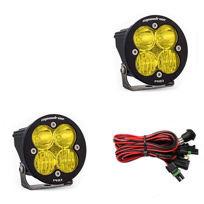

Do you guys know what fog light kit this is? I've seen a couple 4 LED kits out that there have great clear output but haven't been able to figure out the manufacturer.

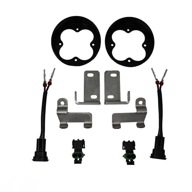

That's been driving me crazy, thank you! So the squadron kit fits BEHIND the plastic shroud on the stock light?
well the stock OEM fog light bezel/ring is fake, so yes, it mounts up in the stock location from the rear fog light opening, and you keep the oem fog light bezel/ring.
Baja design and rigid have kits. I didnt care for the rigid design as the baja looks more oem. I just put mine in last weekend and am super happy with them.
It's a Baja Designs Squadron-R kit. Love mine. Although if you're planning on using it on the road, stick with the Sport model, the Pro's are too bright.
I just ordered the Squadron R Sport kit in Amber from Rago yesterday, looking forward to getting them installed.
