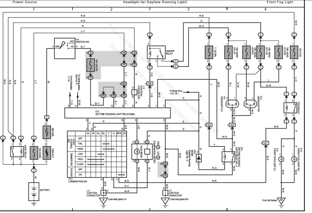

I am not an electrical guru by any means, but as I read this it seems like the Fog light circuit is VERY basic. With only about 5 different wires to trace. Is this correct? Any ideas on where the problem is likely occuring?
Throw another fuse in and remove both bulbs, if it pops again than you have a short in your wiring, if not, then it's the bulbs.
I bet you have a wire crossed within the fog light housing. Or, when installing the bulbs created a short. Just one bulb can obviously blow the fuse and both lights wont work.
A few things I'd do:
1) Double check to make sure there are no wires crossed (As in your + crossing with a ground, or any metal at all)
2) When no bulbs are in, test ohm reading by placing one probe on the positive part of the connection, and one on the ground. If there's any reading besides 1 (infinite), then you've got a crossed wire.
3) Another quick test is to turn the fogs on without bulbs, and see if the fuse still blows. If it does, then its once again a crossed wire. If it doesn't then 1 of the bulbs are causing the short.
4) Make sure all your aux wiring you did yourself did not fray up against any sharp edges, as that could cause a short as well.
5) Lastly, make sure that the fuse is rated to handle your brake line amp and fog light amps... Convert your multimeter to an ammeter and test the draw by placing the probes where the fuse would be. Be careful to make sure your ammeter has a big enough fuse to handle this (30A).

Anyway, you guys are awesome. Last night was my anniversary so I had no time to fiddle with it, but this morning I figured it out!
First I unplugged the lights, popped in a new fuse, and turned the lights on, no fuse popping.
SO I undid the assembly for the lights, took the bulbs out, moved the wire for the ground on the inside a little further out of the way and ensured when closing that my power wire was not touching any of the grounding mechanism.
After that I put everything back together and plugged 1 light in at a time, turning them on in between, so that if the fuse popped I would know which light was the one giving me grief.
Anyway, neither of them caused the fuse to pop after that so I hooked them both up, bolted them on, switched them on, and BAM foglights.
Thanks for your help guys!
