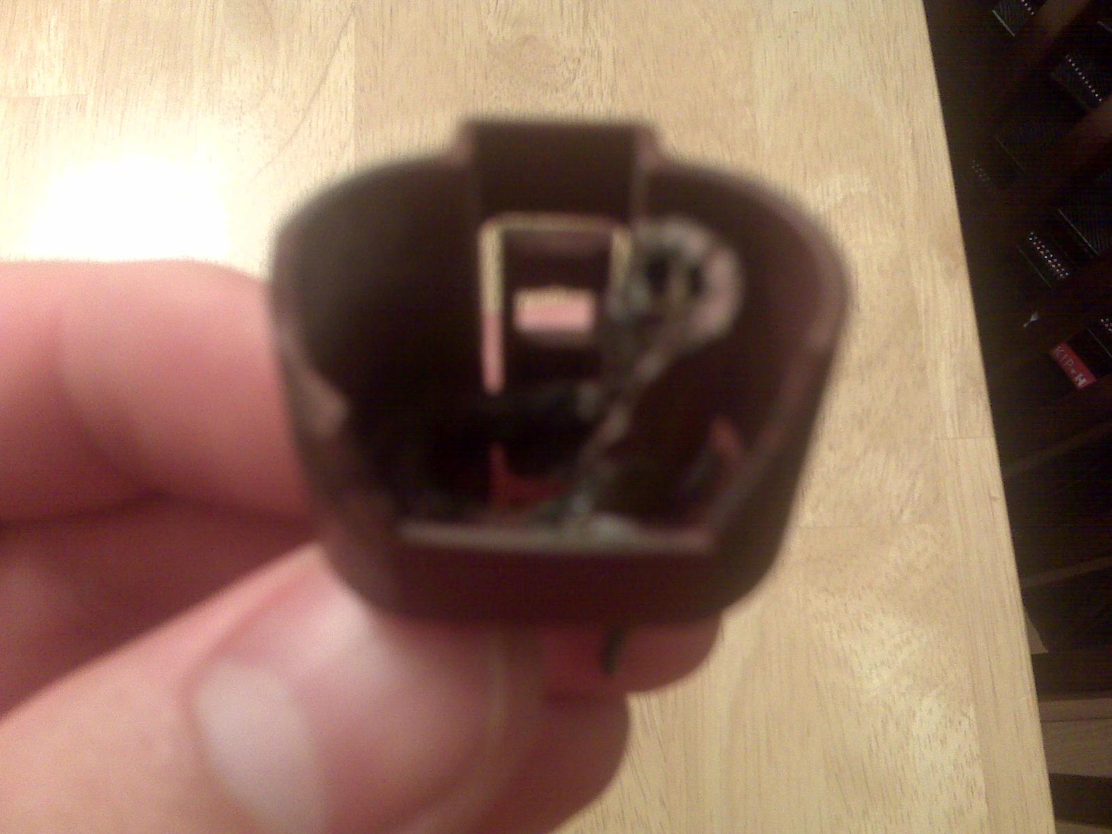

Anyone recently have to replace a housing along with a terminal on a 4th generation 4 runner? Mine melted over the weekend due to a faulty connection so I picked one up at the stealership this morning. I think one of the terminals is still salvagable from the housing so I only picked up the physical housing and 1 terminal. Turns out it wasn't.

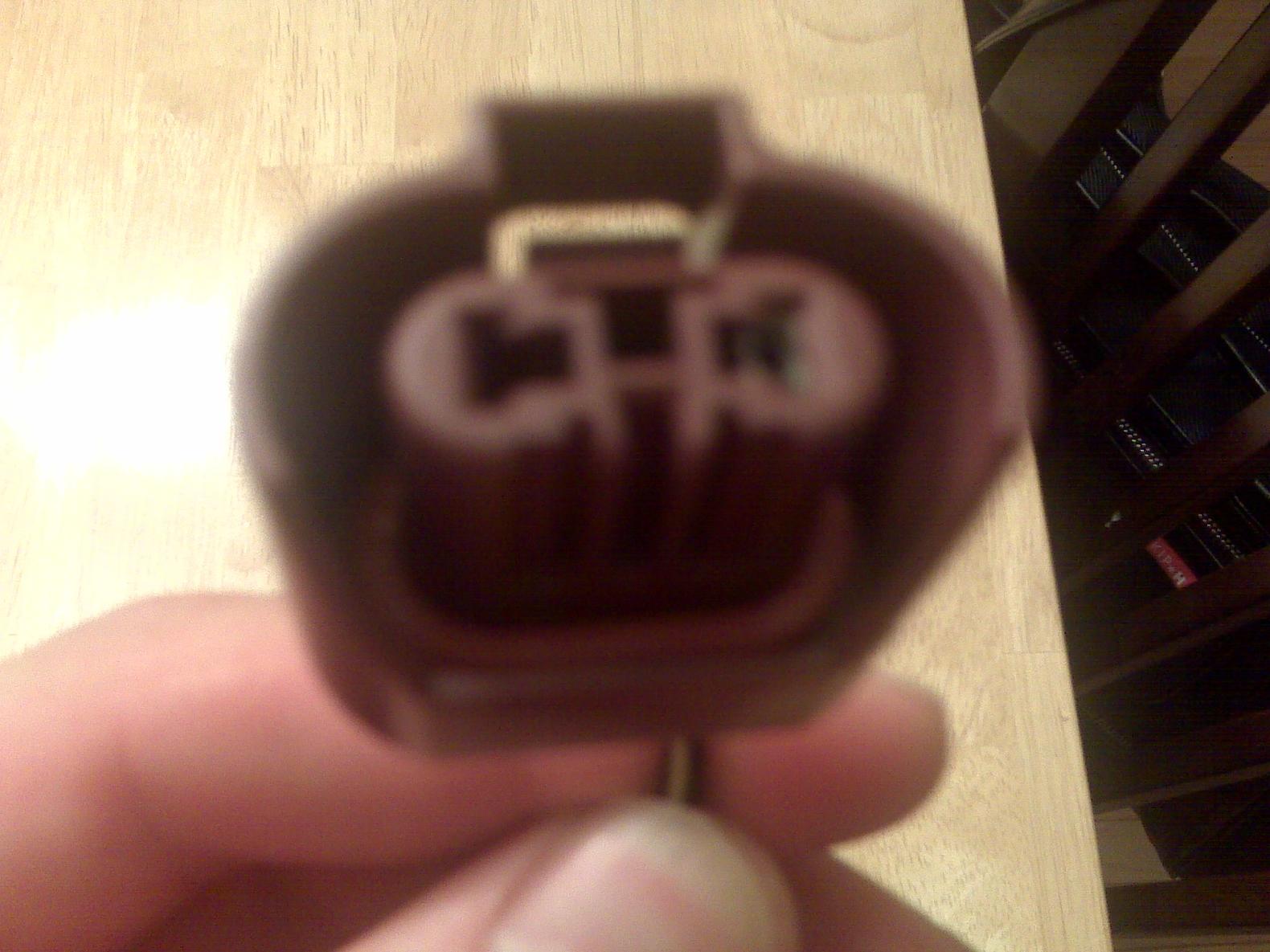

If the wires aren't damaged, you should be able to release them from the plastic connectors and insert them into the new one. You just need a really small screwdriver to release the pins/wires inside the connector. Of course if the connector is melted badly, you might not be able to release & remove them, but if you can it is probably a better option than splicing the wires.

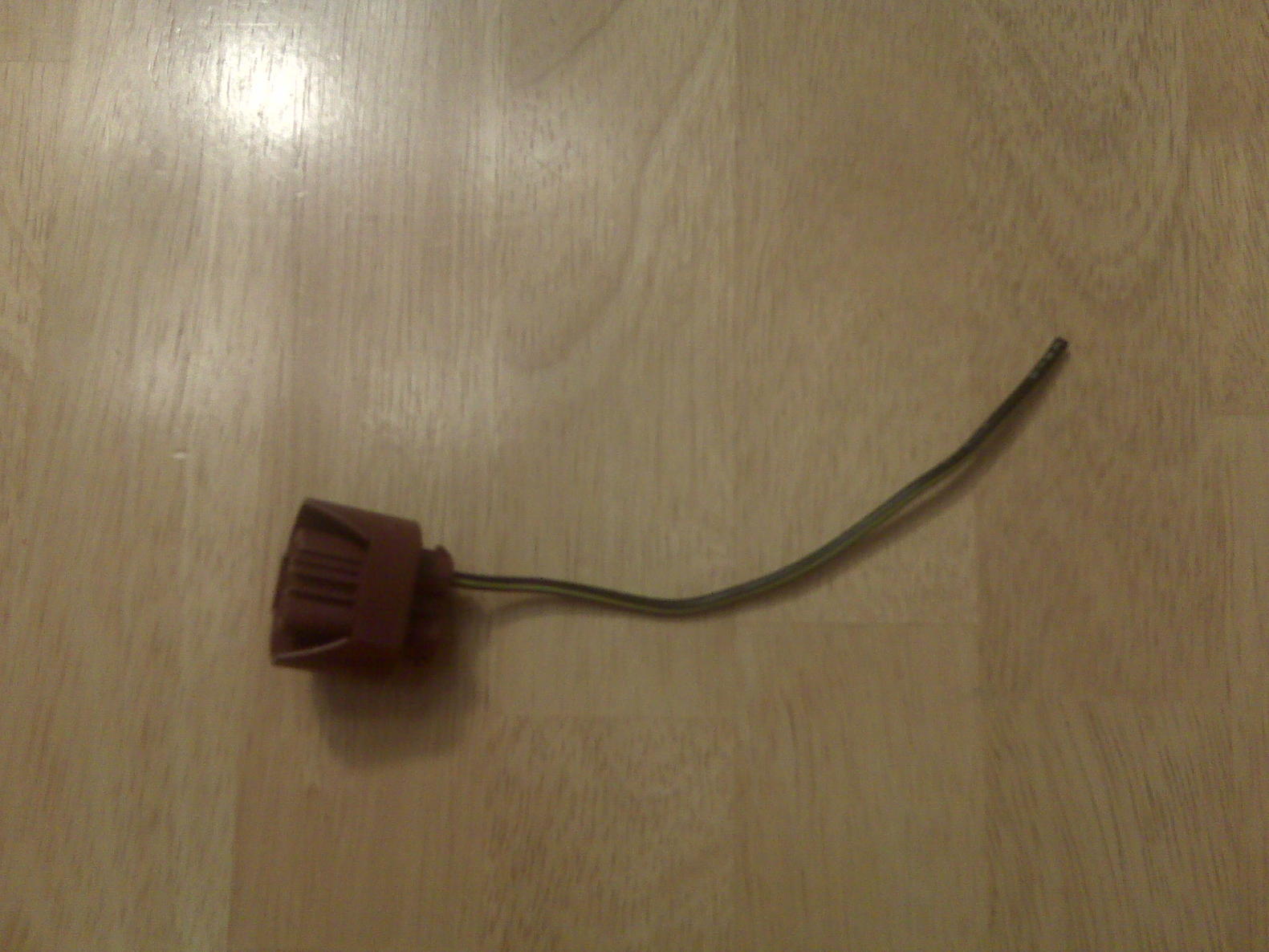

I had to buy the terminal seperate from the connector/housing. It just plugs right into the housing. The connector was $10.

Okay, I understand that. I was asking if the connector itself came with any wires sticking out of it (as in pigtails) or was it just a bare connector? Either way, if you can manage to remove the wires and terminal ends from the burned connector, you will not have to do any splicing.

I think it was either the foglight itself (70w output but draws 55w), but considering the other foglight was fine, I tend to think it was the fact the bulb wasn't pushed in all of the way.

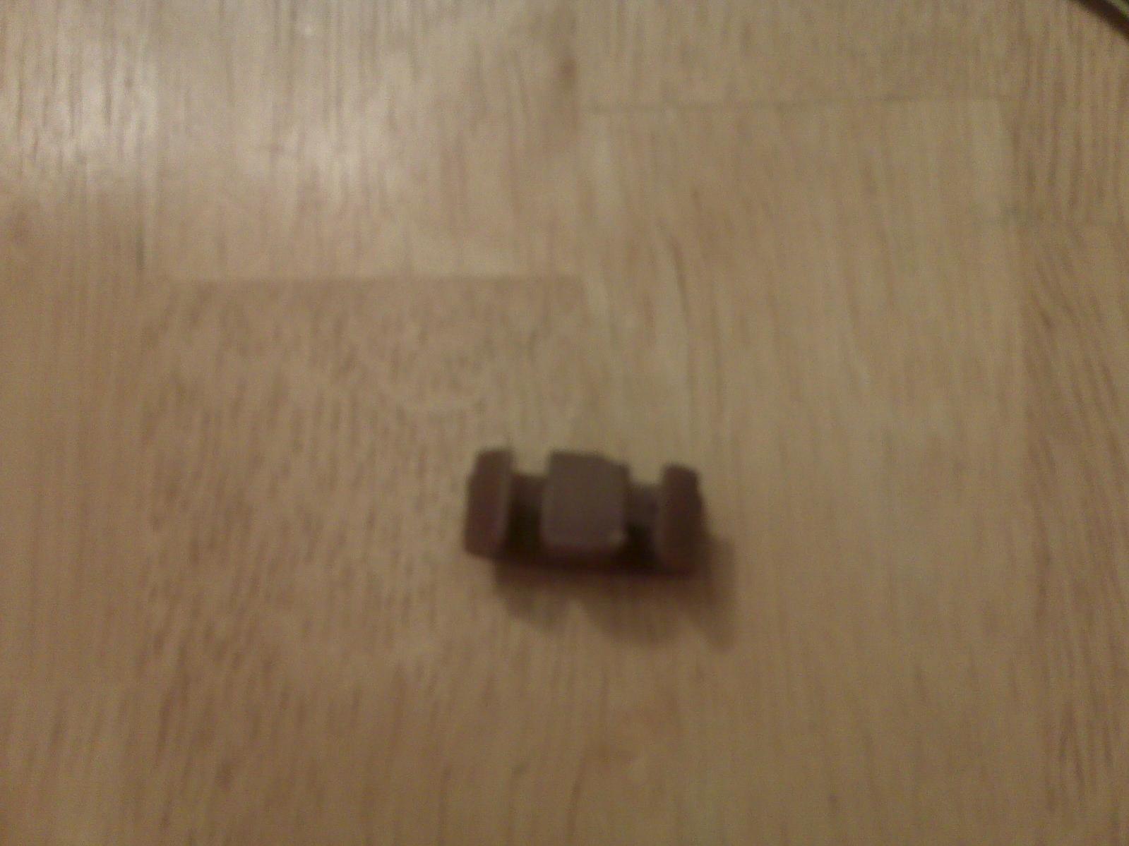

Either way i think I hear what you are saying now. Both terminals were shot and the new ones came with wiring already attached hence my question regarding regarding splicing. I took these pics with my blackberry for quicker upload and you will see a pic of my fried housing, new housing, new housing with terminal attached and lower part of old housing that I think I can reuse that locks the terminal in place.
